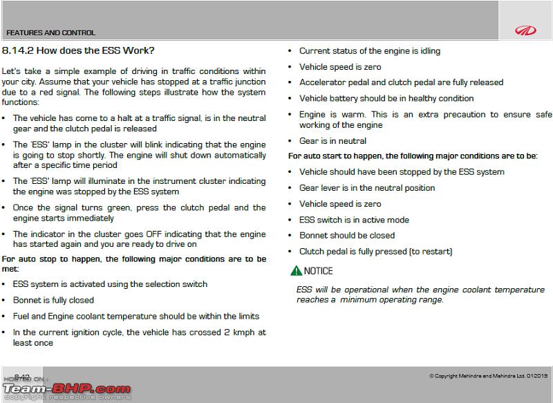

Did a quick check of the XUV300's manual.
Some extracts from the online manual :
Even for cold starts it discourages idling, the engine start system handles that by raising the rpm and them rolling back to normal after operating temperature is reached.
Recommends a few seconds of idling before shutdown.
The ESS considers a variety of parameters before stopping the engine so like mentioned it should be smart enough.
So the auto-start-stop system can be used without any concerns in modern turbo engines, the manufacturers wouldn't have put it in if there was any.
But good to know, at least cleared my doubts and will also share this with my friend.

Taking a leaf from the XUV300 manual, all mentions are "a few seconds" for idling before shutdown either by the ESS or manually. I am not sure how many seconds that is. So that's why going by the logic that if they put it there they must have thought about it
GreyNomad, Sorry saw your post late again, will quote the next time for sure
XUV300 didn't mention anything about the ambient temperature, but I haven't gone through the entire section.
About the rolling in neutral, there should be a speed check as well.
Here are XUV300's :
