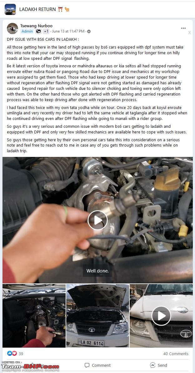

Not an owner but read this yesterday on a popular Ladakh FB group about DPF issues in BS6 diesels and he himself faced it in his Tata Yodha.
DPF ISSUE WITH BS6 CARS IN LADAKH :
All those getting here in the land of high passes by bs6 cars equipped with dpf system must take this into note that your car may stopped running if you continue driving for longer time on hilly roads at low speed after DPF signal flashing.
Be it latest version of toyota innova or mahindra altauraus or kia seltos all had stopped running enroute either nubra Road or pangong Road due to DPF issue and mechanics at my workshop were assigned to get them fixed. Those who had keep driving at lower speed for longer time without regeneration after flashing DPF signal were not getting started as damaged has already caused beyond repair for such vehicle due to silencer choking and toeing were only option left with them. On the other hand those who got alerted with DPF flashing and carried regeneration process was able to keep driving after done with regeneration process.
I had faced this twice with my own tata yodha while on tour. Once 20 days back at koyul enroute umlingla and very recently my driver had to left the same vehicle at taglangla after it stopped when he continued driving even after DPF flashing while going to manali with a rider group.
So guys it's a very serious and common issue with modern bs6 cars getting to ladakh and equipped with DPF and only very few skilled mechanics are available here to cope with such issues.
So guys those getting here by their own personal cars take this into consideration on a serious note and feel free to reach out to me in case any of you gets through such problems while on ladakh trip.
