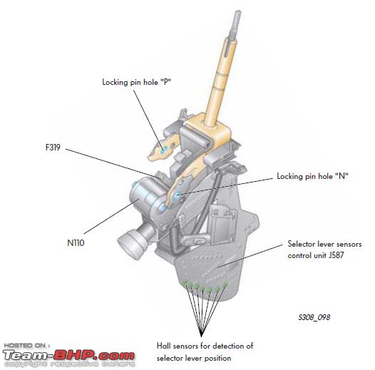

When standing at a traffic signal/red light, it is typically suggested to shift into 'neutral' and not necessarily into 'parking' mode. The reason is that from a convenience point of view on a DSG, you just have to shift one notch on the gear lever to move into 'neutral'.
However, from a more technical perspective, as has been pointed out earlier in the thread - the parking lock mechanism is engaged purely mechanically via a 'Bowden' cable between the selector lever and the parking lock lever.
And this cable is what actuates the parking lock.
In a normal/standstill scenario, the cable can exert adequate tension via the in-built holding device to prevent the car from rolling away. However, in the case of a scenario in which there is sudden and overwhelming pressure on the parking lock/cable, the setup can go kaput and can cause serious damage to the associated gearbox element.
This is best examplified by a classical case when somebody possibly rear-ends your vehicle when the car is in 'parking' mode. Say, at a traffic signal by an idiot who is totally careless and ignorant about stopping in time.
Hope this helps clarify things.
Yes, the Park position locks the transmission so the vehicle cannot move, but it is not designed to be a brake, or to take the weight of the car, so should not be used without brakes.
Spot-on, sir. As always with you
That's one of the reason why, when I'm parking, I go to Neutral first, pull the handbrake lever, and put it into P in the end.

Originally Posted by hemanth.anand View Post
I didn't quite get the 8th Commandment
To elaborate on this point, let me put up the concerned diagram for the selector lever assembly:-
Name:  selector level design.png
The primary function for the Hall sensors of the selector lever is to register the position of the lever and make it available to the mechatronics unit via the CAN bus.
Based on these signals, the control unit implements the driver's D or R or S or Tiptronic command and controls starter release.
Now, if the control unit detects incomplete or incorrect selector lever position attributed to improper lever movement by the driver, then the unit in turn, may not be able to comprehend or advise the correct clutch movements.
The incorrect movement also puts a lot of strain on the lever wiring harness, which could result in severe damage to the entire assembly.
