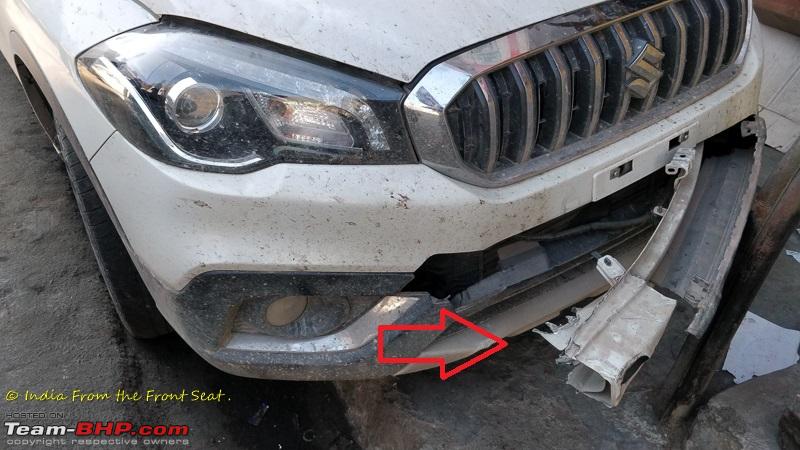

In my drive, I had to be towed out on a tricky situation.
What do you do when you want to be towed? You will not miss the tow hook given as a part of the tools given with the car and the unmissable opening in the front bumper to attach that tow hook.
You will immediately go for that small opening in the front bumper, attach the tow hook provided and be ready to be towed out.
This is what happens if you do that
S-Cross' suspicious build: Towing rips out the tow hook & front members-img_20181015_084533.jpg
The whole member tears apart with the bumper like paper

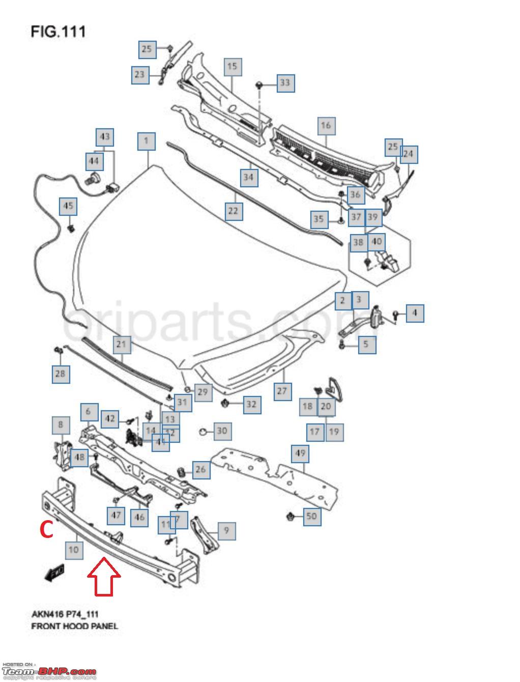

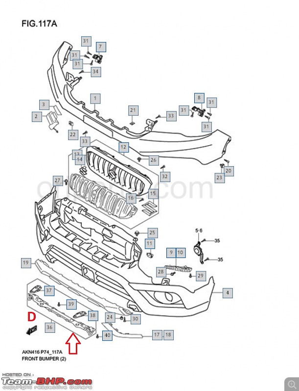

Let us now understand how SCross is constructed. Let us have a look at the parts and diagrams.
Detailed diagram for the front Body parts
S-Cross' suspicious build: Towing rips out the tow hook & front members-body-panel.jpg
Detailed diagram for the Bonnet parts
S-Cross' suspicious build: Towing rips out the tow hook & front members-bonnet.jpg
Detailed diagram for the Front Bumper parts
S-Cross' suspicious build: Towing rips out the tow hook & front members-bumper.jpg
I have marked 4 parts, A,B, C and D
A - Member assembly Apron Side RH
B - Member assembly Apron Side LH
C - Member front bumper, which is bolted to A and B from front, and also has the place to attach the tow hook, after removing the bumper cap.
D - Member radiator support, which has two tow hooks on both ends, and is again bolted to A and B from below. If you go under the car you can see these tow hooks.
Now the whole thing looks dicey. All the tow possibilities that you get are on places that cannot take such forces that arise out of towing.

From the detailed diagrams of SCross, you can now very well understand the the three tow hooks given in the front for SCross does not even stand a chance to take the forces and jerks arriving out of a towing scenario. Scross simply fails in its engineering here. Just two bolts and sheet metal? Its simply not done
Bottom line, if SCross gets stuck, the engineering of this car can make you more stranded!! I just wanted to be towed out, and ended with my entire front body tearing out and going out of alignment.

When I was going through my ordeal, about 10KMs away from Tapovan, or 35Kms from Joshimath, Uttaranchal, I thought help is nearby. Joshimath is a significant town on Badrinath route, even the district SDM has an office here. I thought I would get a Maruti Service centre there. It was not to be. Nearest one was 100plus kilometers away.
We got the details of that service center and called up. It was Rohan Motors in Gopeshwar, nearly 100Kms from our place. We spoke for support nearby, and we were told its either in Gopeshwar side or Badrinath side, both 100 plus kms away. In fact they themselves suggested we get local support from Joshimath, and gave some contacts to get going.
We also asked if spares would be available, and were told SCross spares will need to be placed and its delay to reach them will be there. Radiator have taken the brunt, so wanted to check if that would be available. My belief was its the national engine, parts would be similar. But it turned out to be a perception again.
So for me point 10, and point 11 has been proven wrong on the run. So its like owning any other manufacturer car. Maruti doesn't have an advantage nor the national engine.
I was really frustrated that the basic premise of my purchasing this car is been proven wrong, and that too leaving me miserable with a car that fails on you when you want to get out of where you are stranded.
Coming back to dislikes, I was ready to accept point 4 as a feature. I was ready to live with that. I consciously tried to love this car. But alas, my experience makes me think.
I now believe point 12 of dislikes section was not without reason.
I love my Kungfu Panda, I am in shock very much as he is. I got him ready to drive back home from Joshimath, two good mechanics, the real heroes of India, who went out of the way to help me bring him home. Kungfu Panda is now at home in Bangalore. He needs to be tended to.
I am sad, frustrated and dejected.
