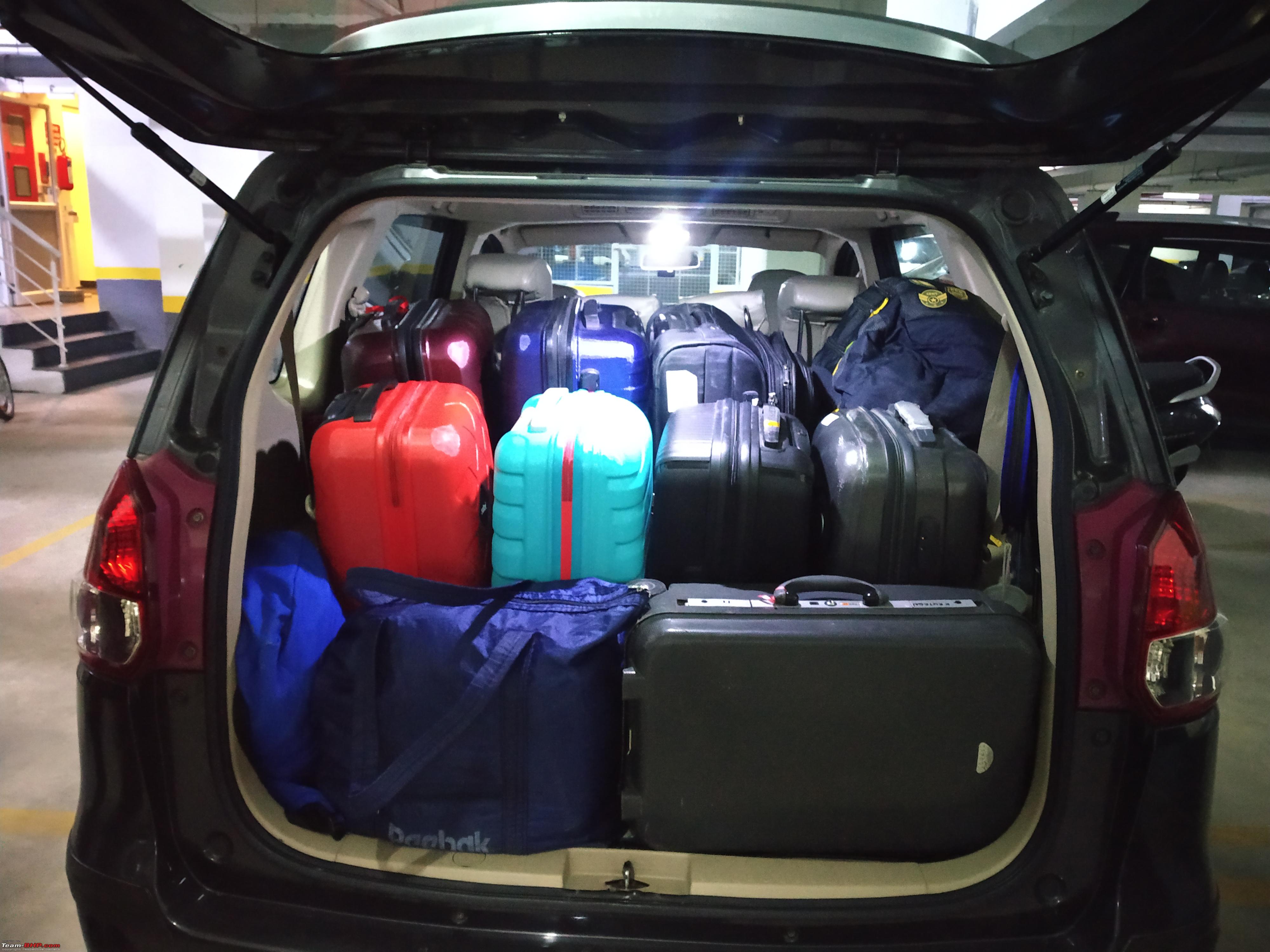

With just the 3rd row folded, this is how we could stack a lot of airport baggage on yesterday in my first gen Ertiga.
Attachment 2101530
I too was enjoying Ertiga with 3rd row folded most of the times. If i am not wrong, the boot used to be 500L+. Only issue being middle row leg room was being compromised(solution was to remove the 3rd row headrests).
Current Ertiga is so much better in all these aspects with split 3rd row seats and extra length without compromising middle row space.
Not sure on the capacity with the 3rd row folded but the space it would liberate makes it much usable than 500 liters for sure. And don't forget the height advantage. I have stacked the baggage vertically and still get a clean view on my IRVM, something that you may not be able to do in most regular cars.
True. I always remove headrests to get whatever extra centimeters of space to give second row passengers a better legroom. You can actually see 2 extra headrests resting on the second row between the 2nd row headrests in the pic I posted above .
Yes. The new one is longer, ensures the 2nd row legroom is not compromised and also the small little luggage space below the boot is big enough to gobble a pair of stroller bags too.

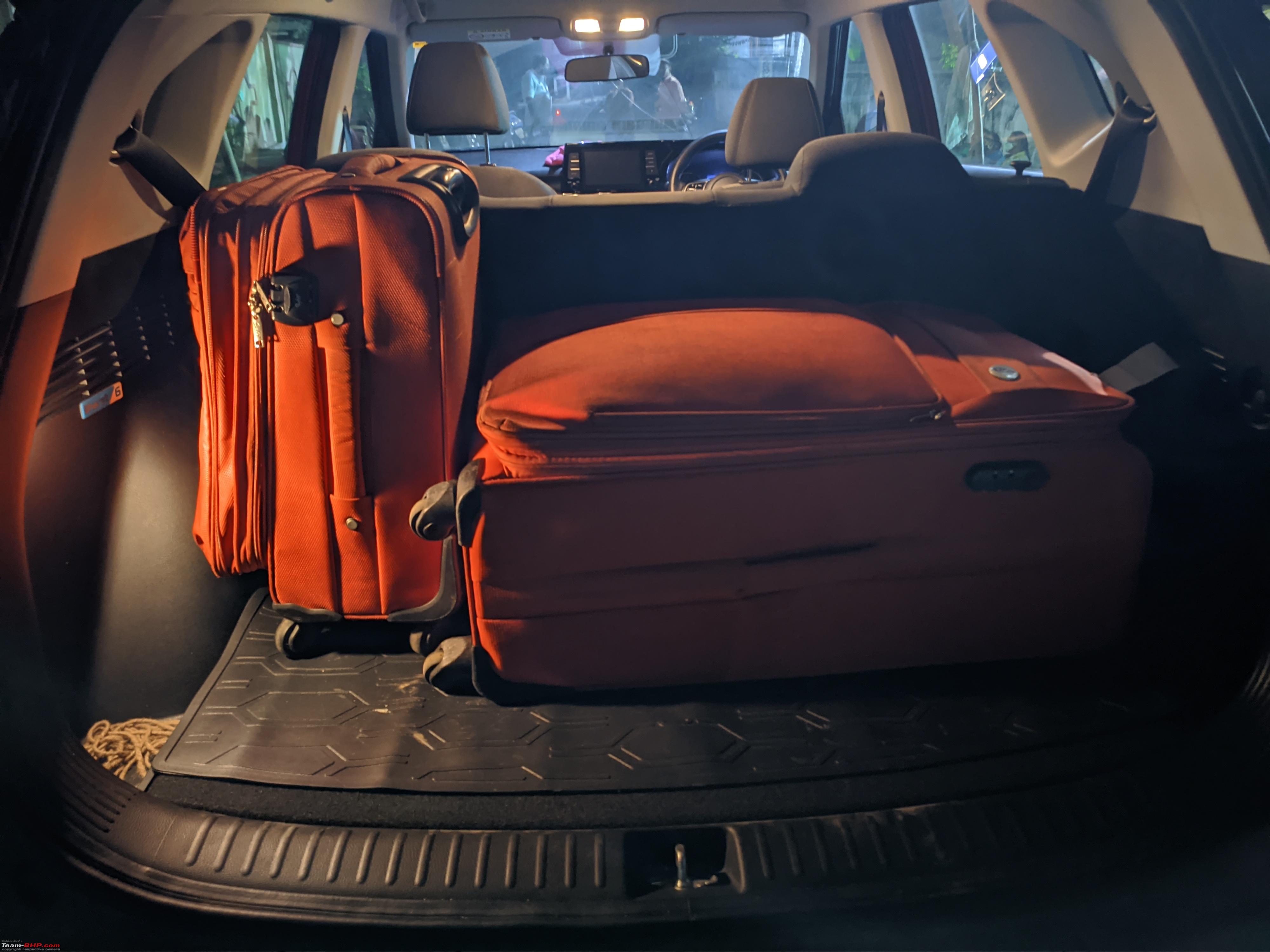

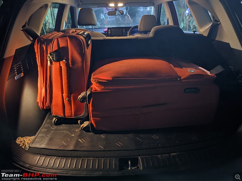

Here is a pic where I have kept a full size suitcase and a medium size suitcase in the Seltos boot. You can check the remaining space.

Well the moot point here is how much luggage will fit below the parcel shelf in the cars and secondly whether the numbers quoted by manufacturers are correct and truly represent the real boot capacity.
If you actually see a Sonet, you will be surprised that the Sonet's usable boot is bigger and more spacious than the Seltos.. please go check for yourself with some luggage.
It is counterintuitive for this to be true but it the the result of some really bad design on the part of the manufacturer where they have not made a spare wheel recess properly and hence it is wasting a ton of usable space in the boot and secondly they are misquoting the boot space to customers who just see the figure and believe them! It is high time that aware customers took a stand on this and forced companies to report the correct usable boot space on a standard metric.

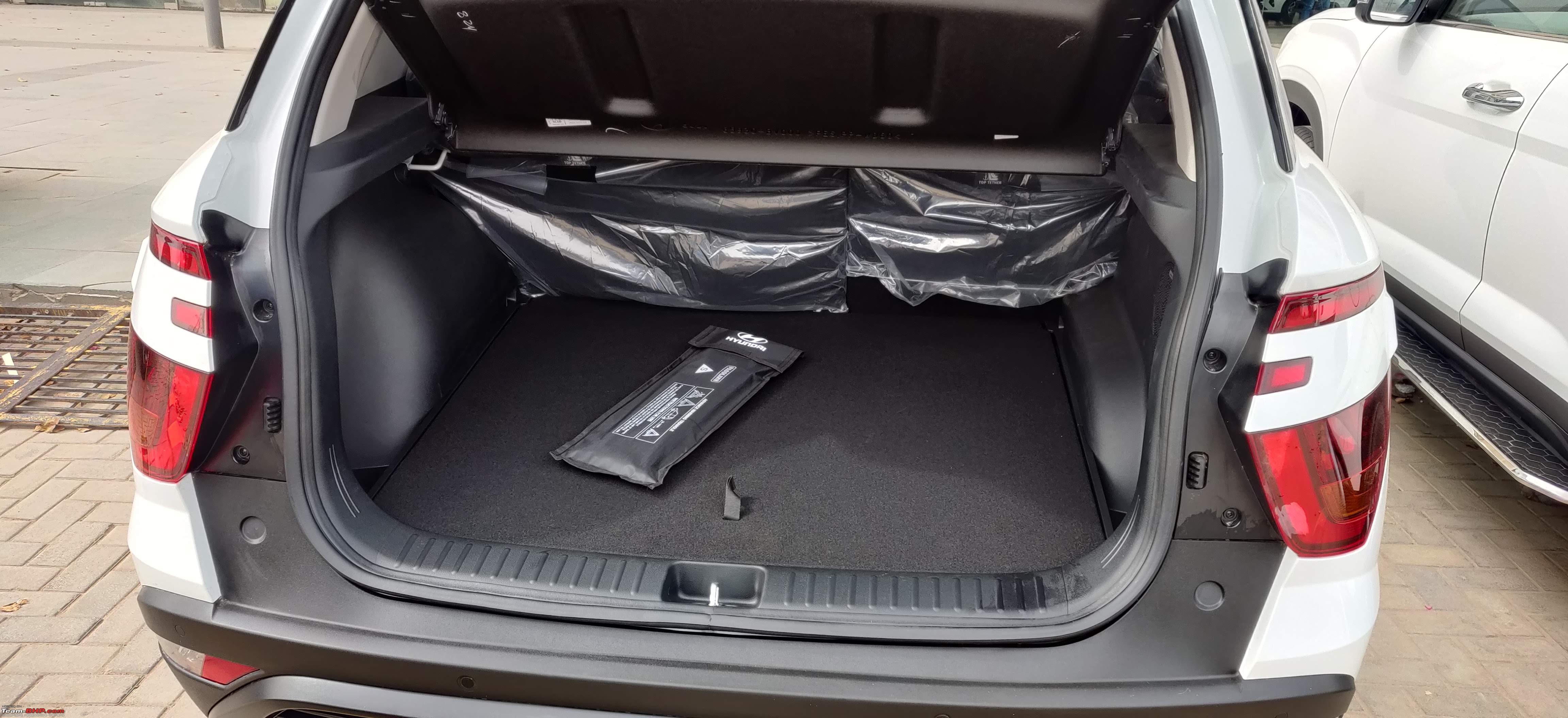

Ok so I went back and measured the Boot of the Hyundai Creta 2020 today and here are the results. The usable space of the Hyundai Creta 2020 is even less than the Kia Seltos.
Pictures are very deceptive and it appears to have a large boot space, but the measurements tell the reality.
The Calculated boot space is :
((50+83)/2 X 40 x 98)/1000 = 260 L and there are two small niches behind the wheel wells, on the left side around 10 L and the right side around 4L (as the subwoofer is mounted on the right side and takes away space) so Total boot space is : 274L
You ask me where all the boot space went? Well a lot of it is wasted under the boot floor and cannot be used. Hyundai is counting all the space in their quoted boot space numbers and also the spare wheel. Notice how shallow the spare wheel recess is and the entire spare wheel is sticking out. (Zoom in to see)
The remaining space around the wheel is usable only for small nick nacks and can never be used for luggage. (Not even a laptop bag will fit)
