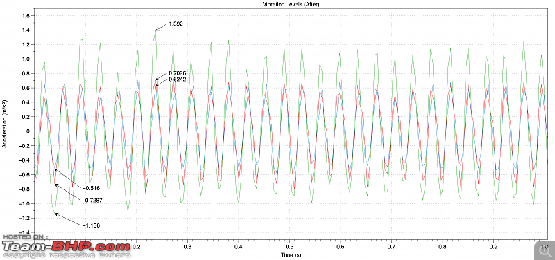

Vibration
Now this was noticeable right after adding CeraTec, though the difference wasn’t that significant then, I could feel a slight change in the vibration that I’m used to while holding the steering wheel. Felt like the vibrations were a bit muffled, just like sensing the vibration of a phone that is in a thick flip case. Vibration sample rate was 202.47/second. Vibration along the coordinate axes are in m/s2, if anyone is interested unit conversions & the math behind vibration measurement, go through this: http://blog.prosig.com/2011/09/05/vi...-displacement/.
This image should make a bit of sense about the coordinate axes with respect to a phone. The phone is stuck to the steering wheel on top of the logo - Ideally(Steering kept steady without moving), moving the car forward or backward will result in large changes in the z-axis while humps would change the y-axis & sideways movement should reflect on the x-axis. There could be measurement errors since the steering axis is not exactly straight & the phone was mounted at a slight angle.
My car has a straight inline 4 engine with the flywheel mounted(and rotating) in parallel with the wheel. Hence, with our mounting setup, the flywheel’s axle is roughly in parallel with our phone’s x-axis. According to right hand rule for torque(http://hyperphysics.phy-astr.gsu.edu/hbase/tord.html), our z-axis should record higher acceleration values since the force due to the flywheel is acting that way. It was evident when I plotted the values.
Before CeraTec, the peak x-axis acceleration recorded for a period of 1 second was 0.8057m/s2, y-axis acceleration recorded was 0.6681/s2 and z-axis acceleration recorded was 1.42m/s2. While the trough recordings for the axes were -0.6768m/s2, -0.4328m/s2 and -1.215m/s2 respectively.
Review: Liqui Moly Cera Tec Friction Modifier in my Skoda Laura-vibration_before.png
After CeraTec, the peak x-axis acceleration recorded for a period of 1 second was 0.7096m/s2, y-axis acceleration recorded was 0.6242m/s2 and z-axis acceleration recorded was 1.392m/s2. While the trough recordings for the axes were -0.7287m/s2, -0.516m/s2 and -1.136m/s2 respectively.
Review: Liqui Moly Cera Tec Friction Modifier in my Skoda Laura-vibration_after.png
Definitely lower values after adding CeraTec. Though by small numbers, this can be felt.

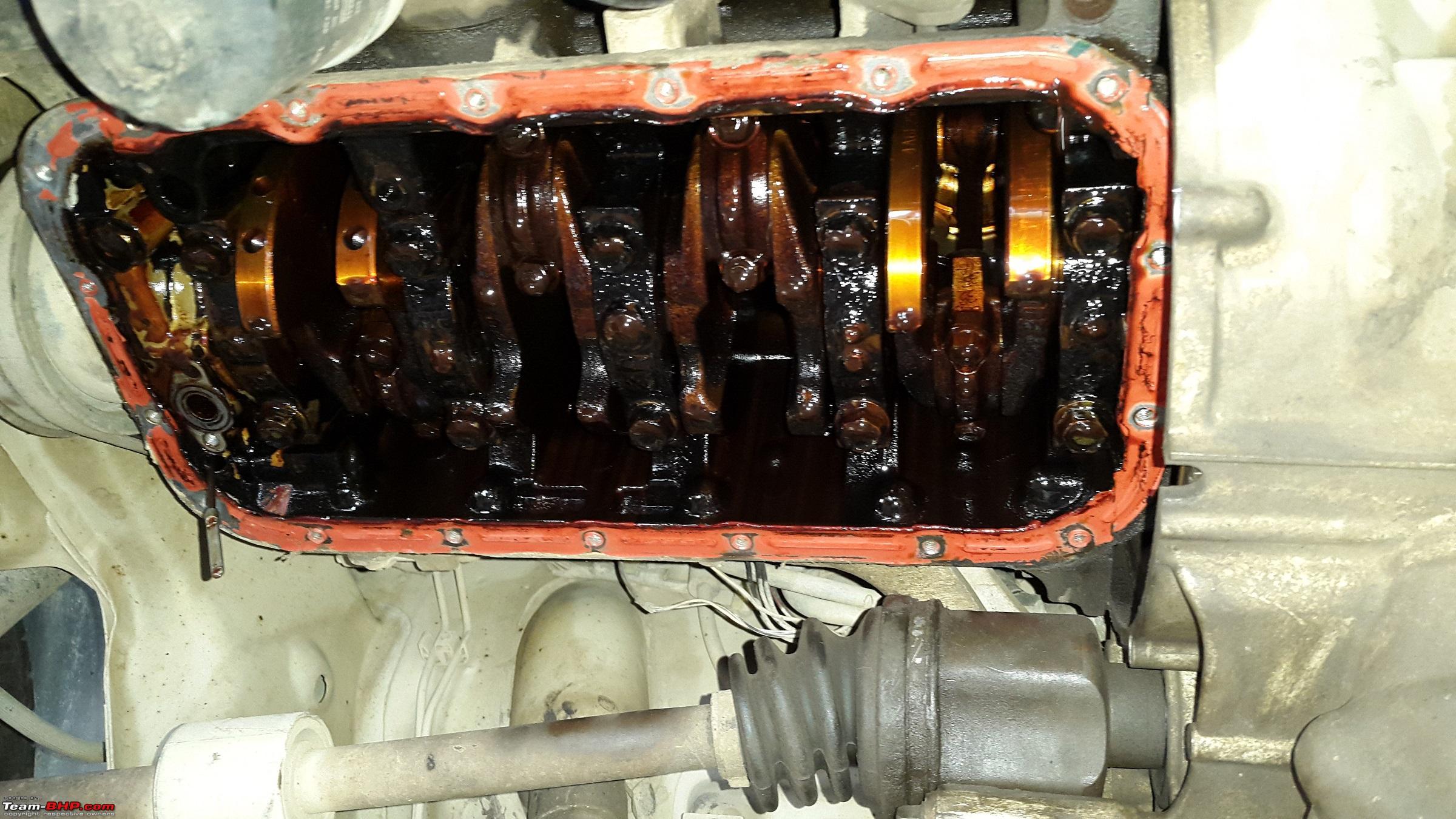

I tried this product way back in 2016 in my humble Maruti 800 5Speed, and this is what I had to say:
The way it was added- My MASS poured in 2L of Liqui Moly 5w40 engine oil. Then 300ml of Ceratec was poured in, and then the engine took close to 600ml of engine oil for the level to come upto max in the dipstick.- The car was then left idling for close to 10 minutes. With every passing second, the sound of engine started decreasing!!
http://www.team-bhp.com/forum/modify...ml#post4087335
http://www.team-bhp.com/forum/long-t...ml#post4107602
My mileage also reached to crazy levels, and there was a marked difference in the smoothness of the engine.
A warning:
Another thing I would like to warn people, specially those with older cars. If your engine has any kind of sludge or carbon buildup, avoid using Ceratec/Fully Synthetic oil. A WagonR user whom I sometimes meet had this issue. His car had done some serious kilometers, but as he didn't change the oil as regularly, there was considerable amount of sludge and carbon in his engine. After he used Ceratec, all hell broke loose. Th ceratec compound mixed with all the sludge and became a semi solid mass and accumulated near the oil strainer(inside sump). That choked the strainer, which eventually caused his engine to run dry. Just 20 kilometers after pouring Ceratec, his engine seized.
Picture of the WagonR:
Review: Liqui Moly Cera Tec Friction Modifier in my Skoda Laura-ceratec.jpg
Hence if you engine has sludging issues, avoid Ceratec.

A warning:
Attachment 1743136
This is just a rumour and a lie propagated by the company. The effect decreases tremendously post an oil change. So if someone is buying it for the 50k kms effect, let me be very clear, it's not going to happen. I used Molygen 5W40 post oil change and didn't use Ceratec and my car is now back to its pre Ceratec behaviour. I am but a happy man as the 5W40 Molygen is perfectly suited to my requirements. I somehow didn't like the unreal smoothness which the Ceratec gives.
Shashi
That really looks awful! Apparently CeraTec increases the viscosity. So I guess it'll do more harm than good on cars that are less looked after. It'll be a nice idea to look for sludge in the car at an FNG or at home before adding CeraTec. Thanks for the heads up Leoshashi, I nearly made a family friend to add CeraTec to his less looked after Ford Ikon!
I also thought the same, CeraTec's effects will disappear the moment the oil is changed.
Conclusion: Next oil change cost = price of oil + price of filter + price of CeraTec + labor!
