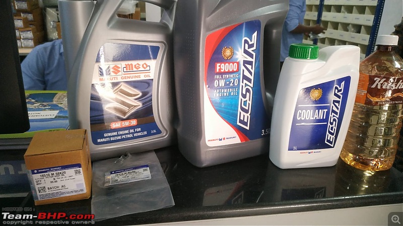

Been through the oil threads and just wondering the oil and coolant you'd recommend for a 2008 Swift ZXi Petrol.
At XL Auto (Authorised MGP Distributor) Chennai, they suggest either of the below oils and the coolant in the photo.
Are these good enough or should I get Shell Helix HX5 5W-30 Premium Mineral Engine Oil.
Thoughts would be greatly appreciated. Tia!
or something like Shell Helix HX8 5W-30 SN Plus Fully Synthetic?
Approved Engine Oils by Maruti Suzuki-whatsapp-image-20220302-11.26.57-am1.jpeg

How much has the vehicle run? The OE lubricants as long as are spec mentioned as recommended in the owners manual are ok to be used. 2008 Swift am not sure if that is the right spec oil not sure but do check.
Jaggu is online now   (1) Thanks
