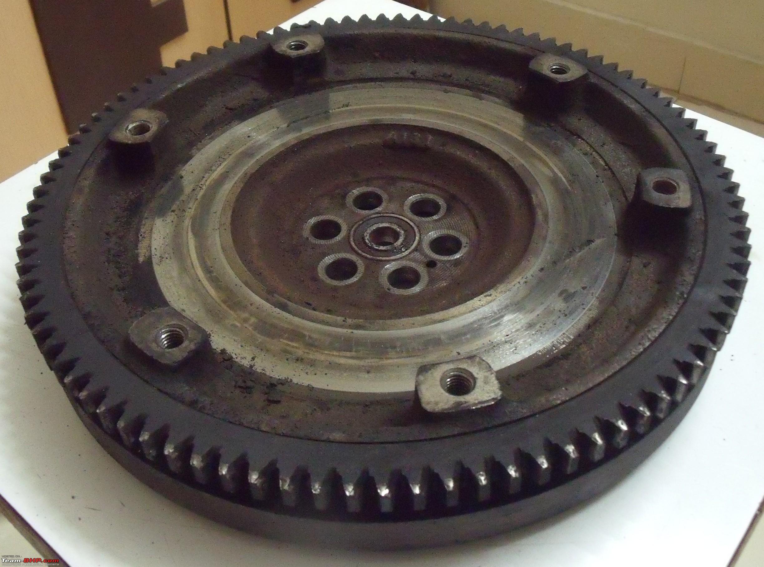

I got the clutch plate of my M800 replaced after 35000 to 40000km. So far the M800 has clocked 89600km. Attaching the photos of the totally worn out clutch and the flywheel. The clutch was so worn out that it damaged the flywheel too.
