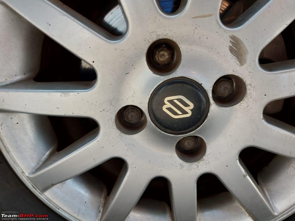

Dear Shashi, can you please help me in locating the part number of the following alloy wheel cap and also if someone can point me out to some local source. Thanks.
Its a 2007 Baleno VXI.

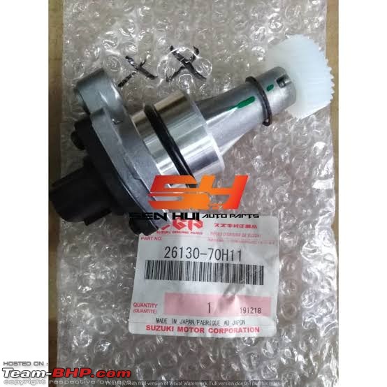

Shashi, could you please post the part# and price of the Vehicle Speed Sensor of the AStar Automatic ?
Name: SENSOR ASSY, SPEED - Part Number: 34960M68P00 - MRP: ₹705.00
I bought this sensor from an MGP store (who also confirmed using their parts manual that the part number indeed matches the AStar_AT), but when the bad sensor was removed from the car, it seems to be different from the one bought - picture below of both sensors.
Do you have the P/N for the sensor on the left ?
Maruti Genuine Parts (MGP) Catalog: Post your queries here (model list on Pg 1)-img_4389.jpg
My mechanic friend says the sensor I bought is used in other cars like Alto etc. Looks like issue with the parts manual.
Will order the correct sensor from MGP. Hopefully it matches and fixes the issue.
The one you need isn't a sensor and is known as Gear, Speedometer Driven. I believe we had discussed this in the past. I recommended changing the cheaper part because it is what goes bad frequently. If its hit and trial which one has to do then begin with the cheaper part first.
The part you show, costs Rs. 3575 and carries part number 26130-70H11. A pic of the same from Google:
Maruti Genuine Parts (MGP) Catalog: Post your queries here (model list on Pg 1)-images-12.jpeg
Shashi
PS: I am not sure if this is the culprit. Still since your friendly mechanic says so, I hope it is.
Leoshashi is offline   (3) Thanks
Indeed we discussed this in detail. The thing is, apparently this cheaper part doesn't exist in the AStar_AT - so cannot be changed. Else, I would have tried it, which was why I bought it. It seems to be a part existing in other Maruti cars- he says he has changed it in the Alto etc.
The part you show, costs Rs. 3575 and carries part number 26130-70H11. A pic of the same from Google.
Thanks, sourcing this should fix the issue. Thanks, again.
I went to the MGP outlet from where I had bought the VSS & told them what my mechanic told me - that it does not exist in the AStar and that I need the "Gear, Speedometer driven". He told me that both are different and both do exist in the A-Star & showed me the parts manual - the VSS in the Speedometer Assembly and the other in the transmission. Exactly what you had mentioned earlier.
Attached the snaps of the parts manual I took. Can't believe my mechanic friend with 30+ years of experience got it wrong.
Though one baffling thing is the part 6 (VSS) is not shown inside the Speedometer Assembly.
