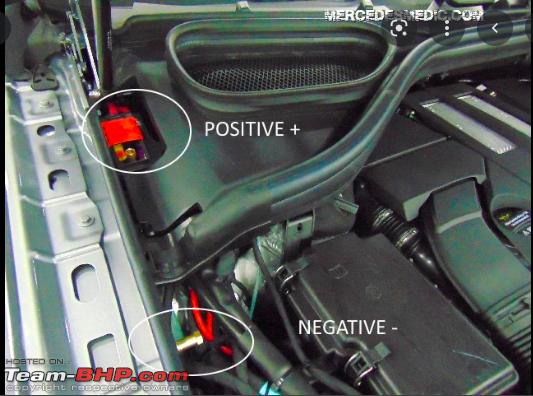

I should mention that Mercedes-Benz hood needs to be slammed shut which I am not a fan of.
Asking the question again, Should the charging points be connected directly to the battery or to the jump start points? If not then the battery cover has to be removed every time we connect the cables.
Name:  Screenshot 20221024 at 12.15.45 PM.png
Also should the Accessory battery used for start-stop be charged separately? Or would it charge along with the main one?
Jump start points should be good.
Which car you are referring to? Very rare for the cars to get two batteries, except EV's and earlier generations of Land-Cruisers
We are advised to use connection points away from "negative terminal" to prevent sparking and fire. For jump starting or charging the battery with alligator clamps, I try to use connection points away from the negative terminal such as jump start posts in Mercedes. In the case of quick connect, there is no question of sparking, etc. The quick connector is permanently connected to the battery terminals and the connection using the quick connector plug.
I don't have model specific information but in general each battery needs to be charged separately. The general advise is only to charge the battery that is responsible for starting the engine whose purpose is well understood and they handle voltage fluctuations better. Some auxiliary batteries, for instance, are responsible for providing a stable voltage to sensitive electronics and trying to charge those batteries might be harmful tp the electronics. Suggest to get a better understanding of model specific details before trying to charge batteries other than the one responsible for cranking the engine.
I am not entirely sure about this; where are you getting this information from? Jumpstart points are different and away from the battery to facilitate easy connection more than anything else. Many EU cars have batteries in the trunk, which are not accessible. As long as you are not adding load or charge on a connected circuit, there are no risks of spark. So, in case of charging, it's recommended to keep the charger off until you have made the connections with the battery. Also, for negative, one can use any clean and strong point on the chassis.
