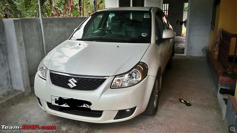

Pictures of my SX4
Maruti SX4 ZDi: Experience with an engine rebuild at 70,000 kms-102bc772d13c494cad3122851bb10070.jpg
Maruti SX4 ZDi: Experience with an engine rebuild at 70,000 kms-609de8d28fa84007b96bb07d71aeab61.jpg
Maruti SX4 ZDi: Experience with an engine rebuild at 70,000 kms-asd.jpg
