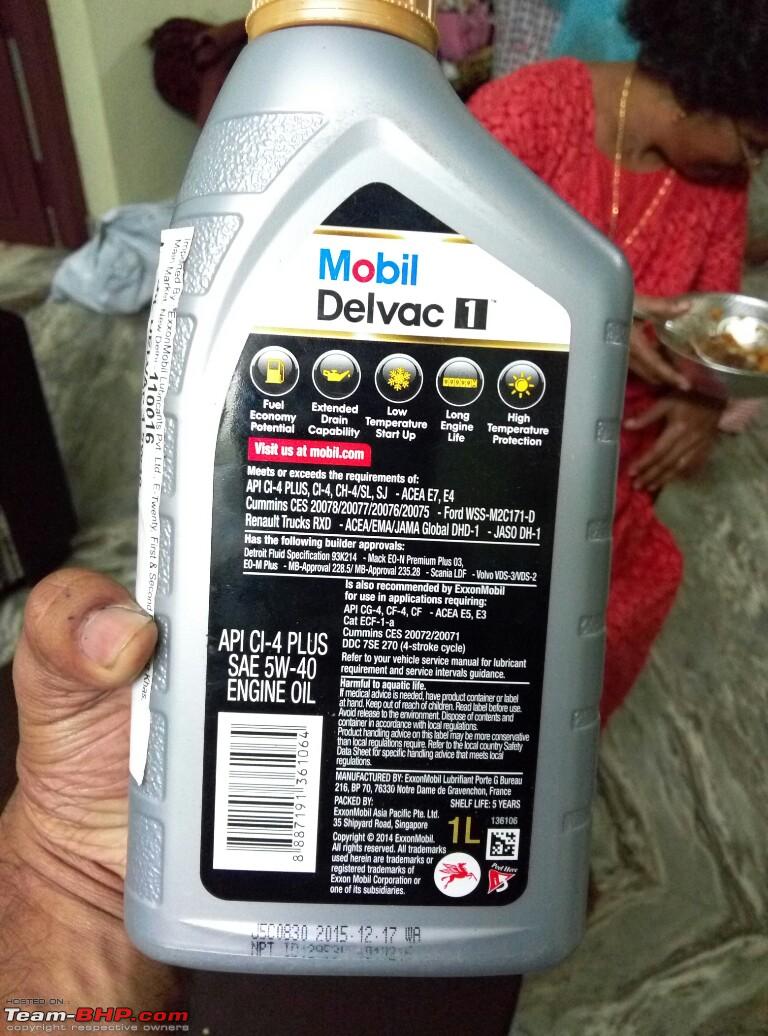

82500 Kms update. Changed engine oil to Mobil Delvac 1 5w40. Car seems to be a little more smoother than when it was on the semi synthetic from after sales. Bought the engine oil at a price of 830 Rs from the distributor. Changed two tyres to Triangle Tr 978 SJHTT .Triangle is a Chinese tyre manufacturer which is popular among many dealers in my locality. Got each piece at a rate of 4500 Rs. All other tyres in the size 205/60 R16 start from a price of about 6200 Rs in my locality. After driving with them for about 1000 Kms feels that they are almost as good as the Goodyear assurance I were using. Good grip and decent ride comfort.
