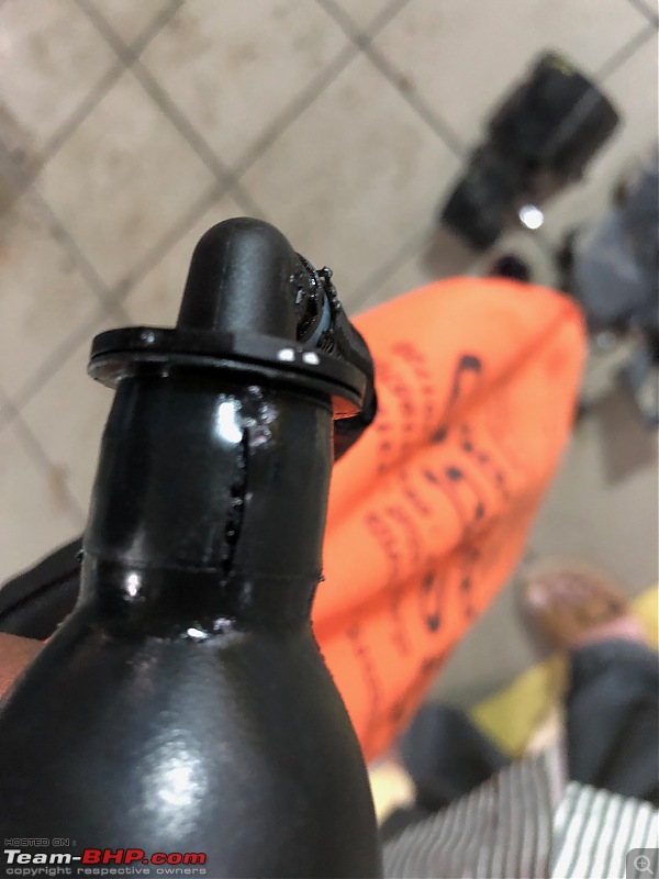

Old 1st December 2018, 19:25   #49
deehunk's Avatar
Posts: 2,026
Thanked: 3,234 Times
Re: Renault Duster 110 PS - Fuel Injector Issue
My vehicle did not start this afternoon, I first suspected a weak battery and called exide batmobile. The guy came in 40 minutes and checked the voltage and tried a jump start, vehicle did not start. Then I checked for fuel leak, on close inspection found a leak in the diesel priming pump. I called Renault helpline and their technician came after an hour. He tried to arrest the leak by tying a condom, never thought a condom can be used this way. Then we finally decided to tow the vehicle as the leak was pretty bad. The dashboard lights were flashing as experienced by other guys in this thread.
deehunk is online now   (2) Thanks
Old 2nd December 2018, 11:39   #50
deehunk's Avatar
Posts: 2,026
I got a call from the dealer today, he tried to tell me the same old story of failure of primary pump and fuel injectors. I very politely told him to replace the priming pump and return the vehicle to me, refused to waste my time by opting for a warranty claim. I will be going to the service station tomorrow.
Old 3rd December 2018, 23:13   #51
deehunk's Avatar
Posts: 2,026
The damaged pump was replaced today at the ASC, I opted for out of warranty replacement. The total bill was Rs.4470 including a GST of Rs.950. I have attached the image of cracked pump and its replacement part.
