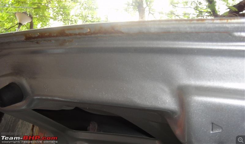

This is what i do:
- Avoid washing as much as possible, instead try to keep the car clean by parking in cleaner spots. My office does not have covered parking, so i used to occupy strategic spots without trees, but having max hours of shade, yes i used to come early just for this lol
- Keep the glass area, mirrors and lights clean during the interim
- When i wash, only a proper wet wash. Even wet mop is not done and if it has to be done, use few mugs of water that can be sprinkled on the car and use a dripping wet cloth to first wipe off and then dry again with wet cloth only
- Dry thoroughly, ensure you dry off all the nooks corners, door frames, bonnet and hood area etc
- Proper underbody wash every 3 months or so during summer months and every month during rains
- Tyres and rims are cleaned thoroughly during under body wash
- Washing is limited to self or 3M (they are worth it). Only underbody at local service stations
- Apply a protective wax coat like Mcguire tech wax every month or so
- All of the above has helped me avoid detailing for couple of years at the least and keep the paint shining and swirl free
7+ year car for proof below, just before she was sold. Just washed and no wax coat for almost 2 months, last detailed about 3 years back at the time when this picture was taken.
Simplified: The Idiot's Guide to keeping your car clean & shiny-image.jpg

Do not wash your car everyday - In our household, it was a regular practice where the washer guy used to pour tonnes of water and give it a wipe. The stains of the water remain helping no cause but instead adds up to accumulation of rust at various micro areas over a longer period of time. A dry or a semi wet wipe on a day to day shall give you the same results and prevent your car from rusting in the long run. Attaching some photographs of the micro areas where the rusting occurs :
Lower part of the front fenders :
Simplified: The Idiot's Guide to keeping your car clean & shiny-dsc04890-2.jpg
Door & Window channels :
Simplified: The Idiot's Guide to keeping your car clean & shiny-dsc04891-2.jpg
Simplified: The Idiot's Guide to keeping your car clean & shiny-dsc04892-2.jpg
Inner side of the Boot :
Simplified: The Idiot's Guide to keeping your car clean & shiny-dsc04896-2.jpg
Note : Not washing the car everyday does not mean you do not wash the Foot Mats everyday. This is a must
