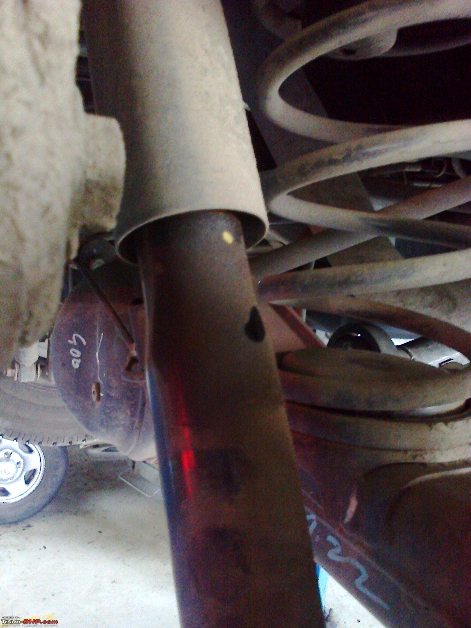

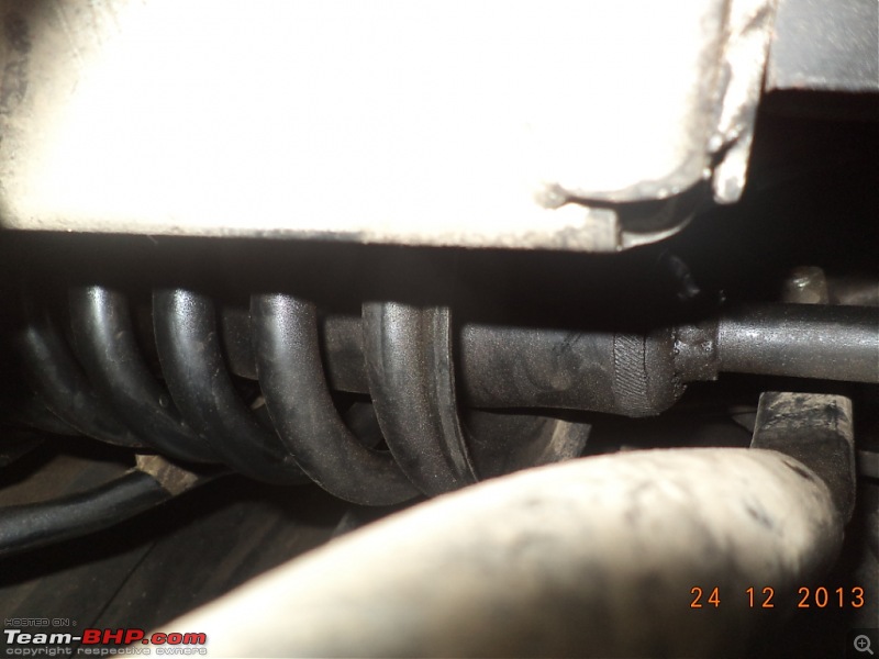

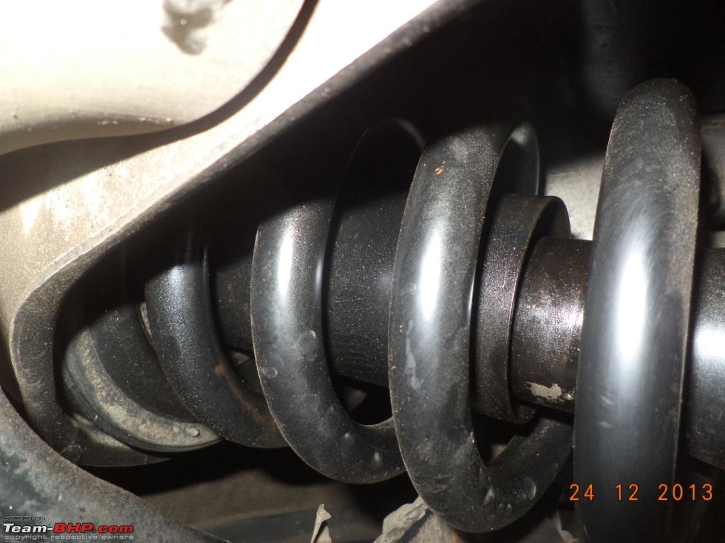

Photos of the offending leaking shocker from the new/replaced once under warranty lot.
Notice the shiny black part of where I swiped my finger to check if it was wet oil/weep.
One of the guys there had the gumption to tell me "itna to hota hai, jumping ke karan thoda excess oil seal ke bahar fenkta hai" .....
And also "fit karte samay thoda oil dalte hain" ..... so I asked him if that was the SOP, why the remaining 3 were bone dry?
Puhleeze!

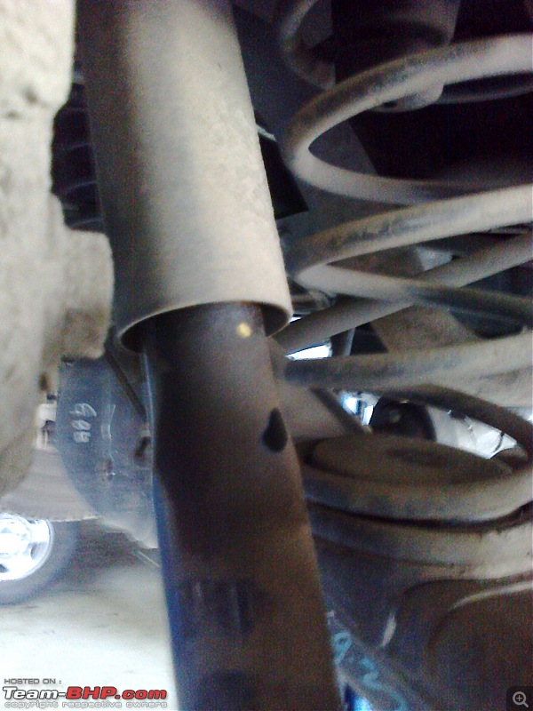

The photos of the leaking front right shocker when the vehicle was raised on the ramp to check for the sump leakage.
They finally agreed that it was a proper leak and agred to change it (what I had been pointing out since the time they replaced the other three). Then the part was not available etc. etc.
Findally the shocker was made available and was replaced.
http://www.team-bhp.com/forum/test-d...ml#post3343579
These are the photos of the leaking shocker before it was replaced ....
