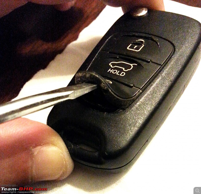

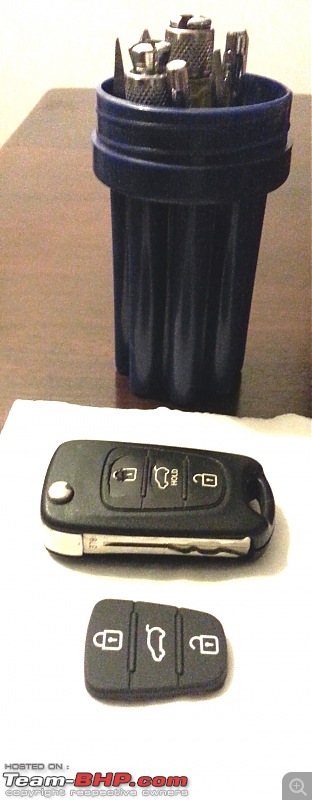

Pic below shows the only tool required for doing this job. The screwdriver blade should be thin enough to go in, without damaging the surrounding plastic of the key and should be wide enough to take out the keypad without tearing it out (in case you just want to clean the metal contacts underneath and replace the keypad after cleaning)
Now using the screwdriver, gently try to pull out the keypad as depicted in the pic below
In my case because of the extreme worn out condition of the keypad, it gave in, when being pulled out. The pic below shows the exposed metal contacts beneath the keypad frame.
