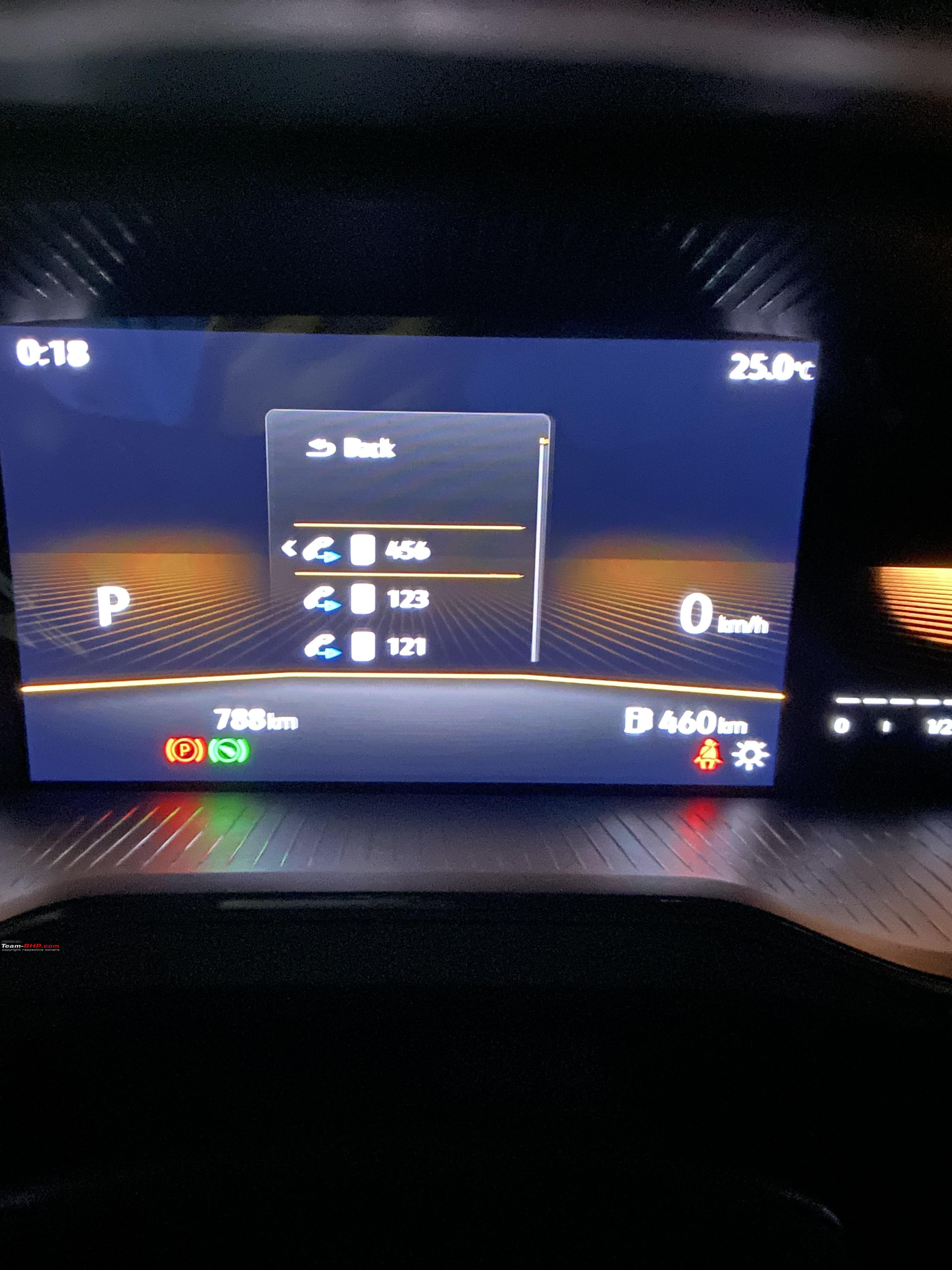

  1. Activated DRL On/ Off option in infotainment
  2. Activated DRL only with light switch on Auto. Light switch off is complete off.
  3. Changed lane change clicks from 3 to 5.
  4. Also figured how to End/ Mute/ Hold and Make Calls (Call Log Based) from Cluster using Steering Wheel Controls.
Image 1: DRL On/ Off Option in Infotainment
VCDS (Vag-Com Diagnostic System) for VW & Skoda - Discussion Thread-img_2301.jpeg
Image 2: Cluster call handling options
VCDS (Vag-Com Diagnostic System) for VW & Skoda - Discussion Thread-img_2295.jpeg
Image 3: Cluster call log
VCDS (Vag-Com Diagnostic System) for VW & Skoda - Discussion Thread-img_2293.jpeg

How exactly is this done?
Apologies for the late response, I was occupied with a wedding in the family.
It's quite simple once you know it, but not very obvious.
There are two ways to access this menu, by selecting telephone (in the customisable menu) or after you've answered a call (as Telephone gets selected for the duration of the call.)
Once you've selected telephone, press the right-hand side scroller (telephone would be pre-selected with an angular bracket, like this: > on the right-hand side), now press the right menu button positioned just below the right-hand scroller, you should be able to see these options.
This hidden menu (>) angular arrow is available for other items as well.
maglev is offline   (1) Thanks
