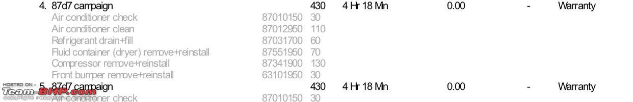

Got the VCDS cable (16.8.3) recently. It is working fine, did an auto scan on my Skoda Superb. The following fault code cropped up:
Address 08: Auto HVAC (J255) Labels: 5K0-907-044.clb
Part No SW: 3T0 907 044 BK HW: 3T0 907 044 BK
Component: Climatronic H18 0506
Revision: 00001007
Coding: 0000001002
Shop #: WSC 33361 790 00999
ASAM Dataset: EV_Climatronic A01010
ROD: EV_ClimaAutoBasis_SK35.rod
VCID: 7CF038BBF7EF86A2E0-8028
1 Fault Found:
9472533 - Temperature Sensor for Evaporator Vent
B108A 15 [008] - Open or Short to Plus
Intermittent - Confirmed - Tested Since Memory Clear
Freeze Frame:
Fault Status: 00000001
Fault Priority: 3
Fault Frequency: 2
Reset counter: 234
Mileage: 51081 km
Date: 2017.01.12
Time: 02:09:43
It is around the same time, the car went in for a service as well as two recalls
1) 23R6 Campaign (emissions recall)
2) 87D7 Campaign (Change of solenoid valve related to the HVAC system). Attaching a picture of the same.
VCDS (Vag-Com Diagnostic System) for VW & Skoda - Discussion Thread-whatsapp-image-20170129-12.37.27-pm.jpeg
The air conditioning system works fine. It would be helpful if anyone could shed some light on the above fault. I haven't cleared the fault. Can i clear it?
