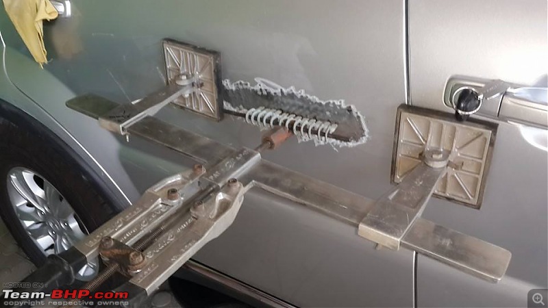

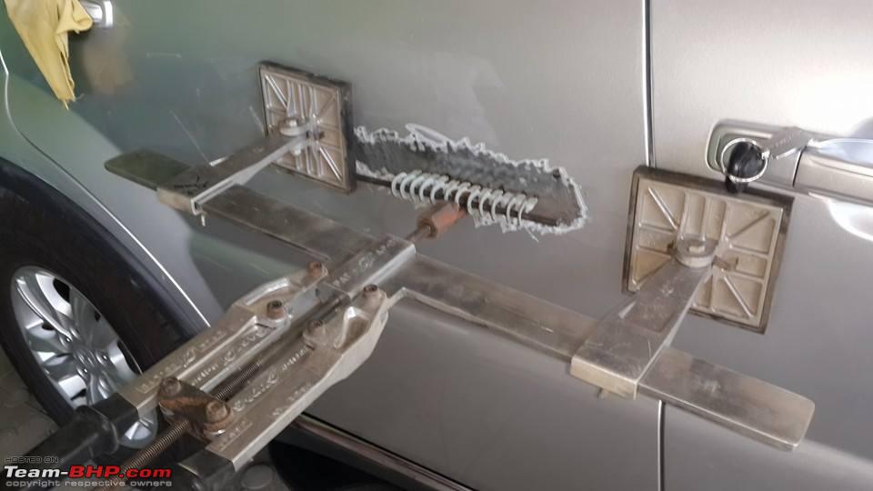

What you need is a body shop that has a dent removing system, for example the Miracle Dent remover. There however is no "miracle", in this.
We spot weld a number of clips onto the outside of the door that needs to be repaired and pull the dent and door back into shape, After the door is brought back into shape over 90%, we finish the rest with bondo and then paint it back to originality, without touching the door inners at all.
Body Repair: How to remove & reinstall Rivets?-dent.jpg

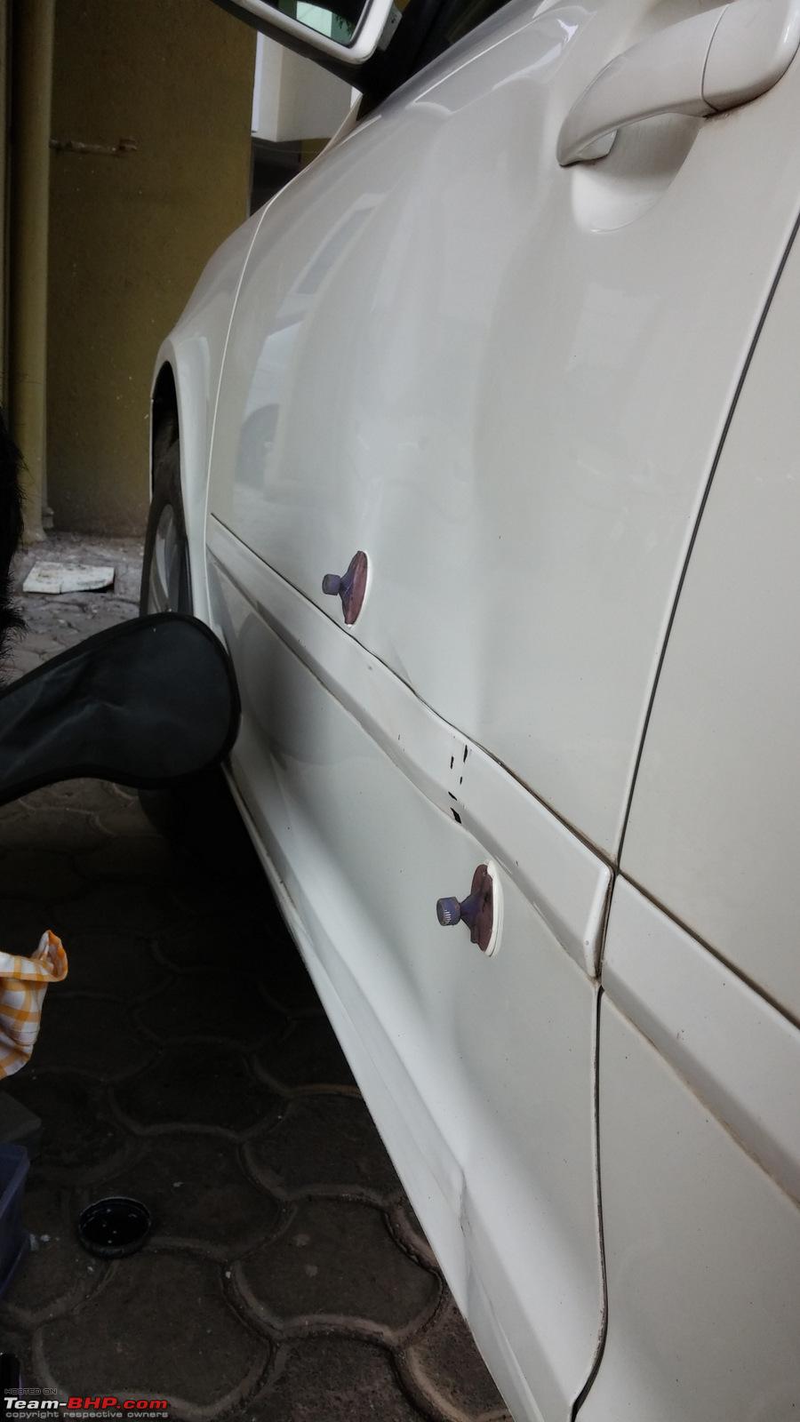

This is how it went:
The overall dent:
Attachment 1252356
A closer look at the dent:
Attachment 1252357
Removing the black marks using some cream:
Attachment 1252358
Attachment 1252359
Starting to pull the dent:
Attachment 1252360
The result:
Attachment 1252361
Attachment 1252362
He requested me not to take pictures when he actually pulled the dents out as that's his USP, so I agreed.
Overall, he could remove 80% of the dent, the side strip posed a challenge, some areas around it could not be restored fully. Also, as per him, when the door received the hit, the metal hit some parts inside (like the glass winder) and hence a couple of small spots around the side-strip got dented from inside. He used a plastic hammer to even them out, but said that only spot welding will restore them fully. Final result is quite acceptable, original paint is intact, and it's no more an eyesore when you look at the car casually. A closer look surely reveals the uneven surface at places. But I can definitely live with this and take my own time to study this whole dent-painting ecosystem, find a competent and reasonable garage that believes in minimizing wastage, has the right tools and most importantly, calls rivets "rivets" and not "ribbits"
Cheers!
Thats a wonderful result. Most part of the dent is not even visible, this definitely is a solution to paintless dent removal, I guess I know what they do to remove the dent and with what tools. I have seen couple of them in Bangalore as well. Have to figure out where they do it. This helps only when the paint hasnt cracked due to impact, if it has then this may not help much. But still a effort which is definitely worth the try.
