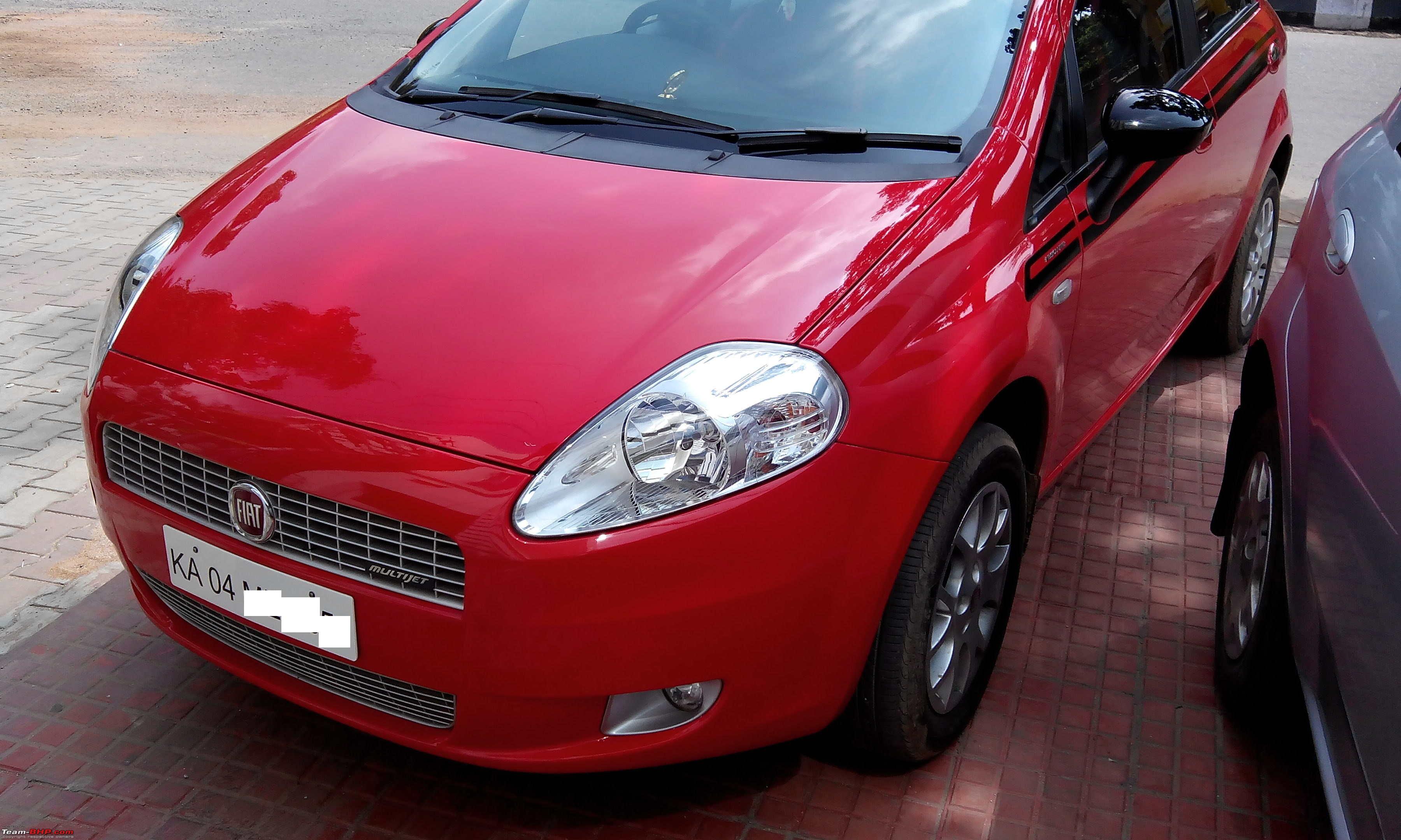

Four Star UPP Sealant Review
Introduction:
People who know me also know that I have a soft corner for LSPs ( Waxes/Sealants).
The thing about these LSPs is that, you spend 15/20 minutes after your regular maintenance wash and bingo, Bob is your uncle. The side effect of trying out so many LSPs is that, I don't get to check the most important aspect of an LSP which is durability. If I ever had to rate the sealants only in terms of looks ( On my Red car ), the award should have gone to BlackFire Wet Diamond ( BFWD ) and WolfGang DeepGloss. These are the two sealants which closely mimic the looks of a Carnauba wax, unlike few others which give typical sealant kind of a look.
The other sealant which was creating buzz around the international market with similar capability was Four Star UPP. A quick check around and UltimateDetailerz had a stock of the same. A quick call and bought some small qty of the same to try out first.
Quick product facts from Four Star's website:
Four Star Ultimate Paint Protection ( http://www.fourstarproducts.com/fostulpapr.html )
Boosted With Polycharger™*
Finally, a synthetic paint sealant that offers the dark, wet-looking, high-gloss shine of the very best Carnauba wax, plus months of protection! Now Boosted With Polycharger™!
Product Claims:
Taken from Four Star website.
Four Star Ultimate Paint Protection delivers months of protection and a deep, dark, wet-looking, high-gloss shimmer that's unmatched by other synthetic polymer sealants. Four Star makes paint care products for OEMs, but saves their latest technology for their house brand. Years of research and testing stand behind each bottle, truly making it worthy of the label "Ultimate Paint Protection!"
Details:
1.- Packaging: Plastic Bottle
2.- Directions: Apply, Haze and buff off.
3.- Viscosity: Liquid ( Medium/thin )
4.- Color: White
5.- Scent: NA/Did not check ( May be too mild to be noticed )
6.- Price: Not available as bought some decanted qty ( Can be checked with Ultimate Detailerz )
8.- Manufacturer: Four Star
Preparation:
The most ignored part and the most important part of the detailing is the prep. Looks/shine/durability everything depends on how well the surface was prepared. So here goes my list of what I did before the UPP sealant application.
1) ONR Wash
2) Clay using ONR as lube
3) Menzerna Power Finish ( Machine polished using Skil 9080 and Lake Country pads )
4) Finished off with BlackFire Finishing Polish
5) UPP Four star 1 Coat ( Usually I apply 3 coats ).
Application:
As I got the decanted Qty, I was worried if the amount of product what I got is sufficient for 2 coats ( It was a small Tar-X bottle which had UPP ). Happy to say that I was pleasantly surprised. This sealant spreads like a Coconut oil ( Not sure what else I can compare with ). One dab from the applicator and you could cover almost half of the bonnet. Remember the key is to apply thin.
Once applied to the full car waited for 5 to 10 minutes and a quick swipe with my finger told me I could remove the sealant. Buffed off with a Micro Fiber cloth. By far this is right up there with the best sealants I have used till date in terms of ease of application, removal as well as the looks. I will let the pictures speak.
Again all pictures are from a Mobile camera ( Not much of a camera person guys, please excuse ).
Verdict:-
Manufacturer Claims:- True ( Exception is the durability which I have not tested )
Looks:- 5/5 ( The only sealant which gets my full marks. The closest next being BFWD )
Ease Of application:- 4/5 ( Could have been 5, but things changed after UPGP )
Protection:- Not tested
Over all:- 4.5/5

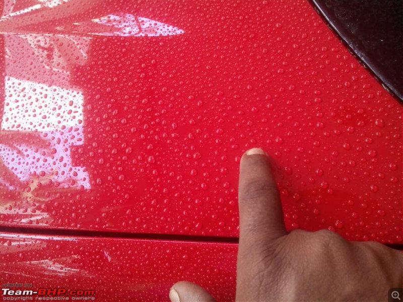

Oh, a sealant review without a beading shot ?. Here you go.
