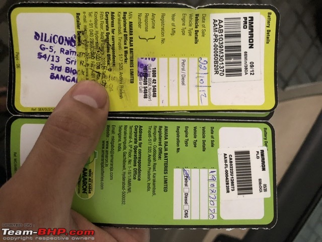

So the Amaron Pro battery of my SX4 started showing signs of weakness after close to 8 years of not so regular use. Recently when my parents had been out shopping, the battery got drained out completely within fifteen minutes while dad was waiting for mom to return. However the headlights were on 100/90w lights with HID fog lights I had to go in the Celerio and Jumpstart the SX4 to bring back my parents home. The battery had withstood all the abuse. After charging it overnight it was back running fine but yesterday when I ventured out in the car for similar shopping duties, I noticed the battery was losing steam within minutes of running in accessory mode even though headlights was switched off. Hence decided its time to retire the battery since it had served more time than I expected and I didn't want another surprise someday. Hence ordered another Amaron battery but compared to last time when I went for the highest warranty version, this time I brought one version lesser, FLO since the longer warranty for me didn't matter now. But I'm impressed by the life of this battery.
I ordered it yesterday in Batterybhai and it was promptly delivered today with Bill and warranty card.
