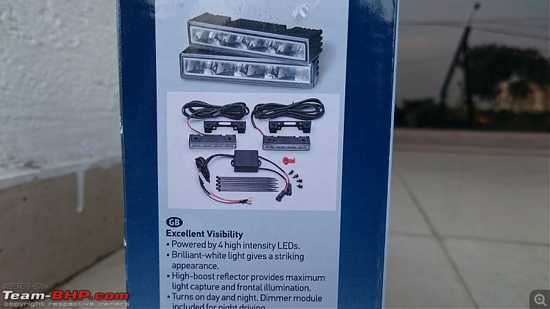

I was looking to install DRLs for my SX4 for a long time, but was worried about any modifications to the stock headlamp assembly, and to the reflectors/lenses in particular. Therefore, my preference was to the add-on DRLs that can be installed easily without any major modifications to the existing headlamp assembly.
So on a casual evening (when I had some free time), I visited a neighborhood accessory shop, and found some nice add-on DRLs available there. There were a few unknown, cheap products - I was not very keen on these. But thankfully, found a nice Hella product, and immediately took the plunge and bough it, and got it installed immediately.
So what I got was this Hella LEDayLine 4 DRLs:
The DRL Thread: Everything about daytime running lights-helladrl1.jpg
It has two DRLs, each with 4 LEDs (later I realized that Hella also has something called LEDayLine 5 and LEDayLine 6, with 5 and 6 LEDs respectively. I would have loved to have 5 LEDs each side, but I realized this only after I installed DayLine 4. Oh, well...).
The kit includes this:
The DRL Thread: Everything about daytime running lights-helladrl2.jpg
The main advantages/features (which I was keen on) are:
  1. It is a very simple add-on. The required fuses and relays are all included in the kit. So no need to tamper with the fuse-box of the car.
  2. The automatic on/off operation: There is a sensor (a vibration sensor actually) which detects engine switching on and off. Thus, the DRLs switch on automatically (with a couple of seconds delay) when the engine is switched on, and go off when the engine is switched off (with a bit more delay, say of about 10 seconds). There is absolutely no additional switch or any control installed anywhere.
  3. There is also a dim mode (with a dimmer module). This is connected to the parking lights. Whenever the parking lights (and therefore, whenever the main headlamps) are switched on, the DRLs go in dim mode. Thus, there is no jazzing light display at night.
  4. They fit flush onto the airdam, and don't stick out and don't look like a mismatch (though unfortunately, they do look like an aftermarket part added to the car, which they are!)
  5. And finally, I checked with some friends by making them observe my lights in broad daylight from a distance - yes, the are bright enough to be easily visible in broad daylight also! So they serve the main purpose of DRLs!

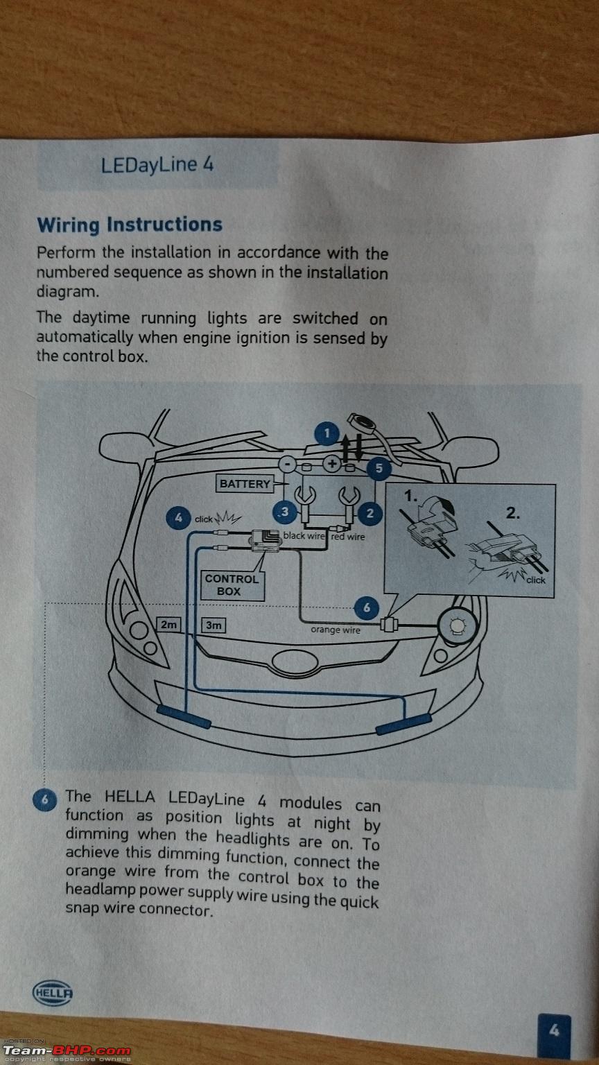

I will post the pictures of the wiring when I get a chance. However, for now, here is the wiring diagram from the cover of the Hella relay kit for headlamps:
The DRL Thread: Everything about daytime running lights-headlampwiring.jpg
And here is the wiring instruction page from the installation manual for the DRLs:
The DRL Thread: Everything about daytime running lights-drlwiring.jpg
Hopefully this will give you some idea about hos the wiring is done. The person doing the installation followed these instructions accurately (I was keen on him doing that), so I assume I have got everything installed fine. But I am still waiting and watching out for any issues I see. It has been only a week since I installed these, and thankfully, so far, there are no issues whatsoever.

Exactly! In my previous post, I have put pictures of the wiring diagram printed on the package. So all one needs is the relay harness and 100/90W H4 bulbs. The install is pretty straightforward after that. This installation took less than 10 minutes.
The DRLs on the other hand took somewhere close to 40 minutes or so, since it includes mounting the brackets (with clips and screws) on the airdam, mounting the actual DRLs inside those brackets, and then doing the wiring. But still, overall it is also a straightforward install with no complications whatsoever.

Originally Posted by sumeshmani View Post
I did think about completely avoiding the connection to parking lamps.
The only benefit that I was considering is reducing the load on the battery when headlights are on. I am not even sure if there is a significant load saving if the DRLs are in dim mode.
I think the load on the battery should not be a big issue with the DRLs. In my case, each LED is 2W, and a total of 8 LEDs (4 on each side) adds up to 16W. This is a negligible load increase on the battery even if I keep the DRLs running all the time (in contrast, even the tiny fog lamps are 35W on each side, totaling 70W).
One thing is for sure, upgrade of headlights and DRL installation now seems a possibility for my car too. Earlier I was scared about the electrical complexity involved.
Absolutely! DRLs should not be any issue whatsoever. However, please keep in mind that most dealers/authorized service centers claim that installation of 100/90W bulbs and the wiring harness would void the warranty regardless of how simple or how clean the install is. So you have to take a careful call here.
Since my car was anyway out of warranty, it was a no-brainier for me to go for it.
