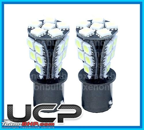

It is brand new car and there is no issue with the wiring. The stock OE Osram bulbs work perfectly with car. I am looking for LED DRL bulbs and NOT LED strips which are fitted off-market. The Bulb specifications are P21W -
The DRL Thread: Everything about daytime running lights-superb-drl-bulb-p21w.jpg
And the LED Bulb needed are something like these (but they should be CANBUS error free)
The DRL Thread: Everything about daytime running lights-superb-drl-p21w-21-smd-1156-canbus-led-white-bulb.jpg
Thanks for your concern BTW. Anyone having any information for these type of bulbs to be locally procured would be most helpful.

I have the same spec DRLs in the Laura. Its very hard to source error free LEDs hence I did a work around by fitting a resistor and its been error free for over a year now. Check my ownership thread for details
