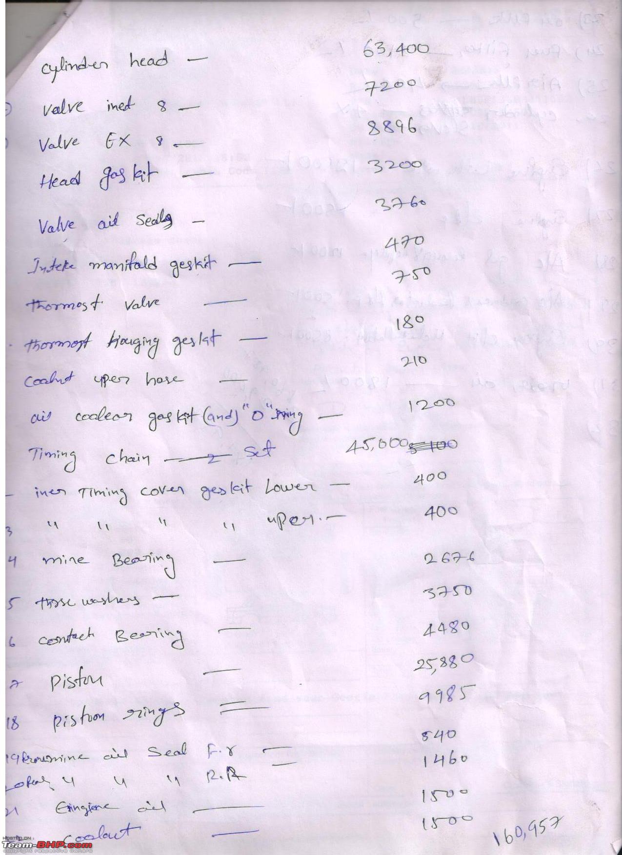

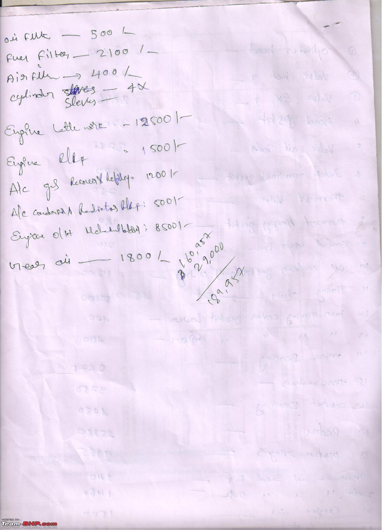

Hyundai i20 engine problem - 34000 km on odo Rs. 2 Lakh repair bill!!!
Posting this on behalf of my friend who has had a harrowing experience With Hyundai service.
My friend had purchased a Hyundai i20 diesel sportz Novemeber 2011 model - 27000 km on odo from a trusted friend who informed him beforehand about an accident involving a dog. The repair work was botched up by two different Hyundai authorised service centers at Kurnool and Anantapur immediately after the incident and finally after speaking with the Hyundai India service head at Delhi, the case was referred to Trident Hyundai Yeswantpur Bangalore. The owner had requested for complete engine replacement and also offered to bear the entire cost, instead it was claimed by the service center that as per company norms engine spares replacement and labour worth almost 2.8 lakh was done free of cost on the car(since it was their mistake) and the engine was now virtually new and completely trouble free for another 2 lakh km(Car was delivered after 3 months on 31st January 2013). The car was purchased by my friend in march 2015 and the latest service was done at lakshmi hyundai Vanasthalipuram branch hyderabad in June 2015 - odo 31200 km.
On 5th august 2015 he noticed that the A/C was emitting hot air while travelling on the Vijayawada-Hyderabad highway and immediately pulled over and called Lakshmi Hyundai service at Vanasthalipuram where he got it serviced 2 months earlier. The service advisor asked him to check for coolant level and it was found that the coolant tank was leaking and was almost empty. The service person asked him to fill the coolant tank with water and drive to the service center which was about 50 km away. My friend insisted on it being towed and the vehicle was towed to the service center. The problem was described initially that the coolant hose got deformed into an oval shape at the radiator inlet and hence the entire coolant leaked out. There was no sign of damage around the radiator or sump due to stone hitting etc. An initial estimate of Rs. 20000 was quoted for head gasket replacement with a disclaimer that they can only confirm after the engine was opened. The jobsheet dated 5-8-2015 is attached for reference. After 4 days the estimation was increased to Rs. 45000 after the engine was opened, yet no confirmation on the final cost of repairs. After continuous follow ups the estimation increased exponentially each time and finally ended up at Rs 1,89,957 as on today (Attached sheet).
The service manager at Lakshmi Hyundai Vanasthalipuram Mr. Gopal Reddy has stated that the Engine head was not replaced with a new one earlier(as claimed by Trident Hyundai, Bangalore) and has been reworked instead which is the root cause for this coolant leak problem and not due to the deformed hose as claimed earlier. My friend visted Trident Hyundai at bangalore and the area service manager Mr. Niranjan Babu accepts that rework was done on the engine head as per instructions from their service head at Delhi. My friend had to visit the Hyundai regional office at Somajiguda Hyderabad as they were not responding properly on the phone. The area manager Mr. Sunil very rudely tells my friend that the vehicle cannot be repaired for free of cost for its entire lifetime and has to pay the entire bill amount. The vehicle was purchased for 5.5 lakh by my friend and now he has to spend another 2 lakh on a car that is less than 4 years old. The car was always serviced at hyundai authorised service centers and this is clearly a failure of the hyundai service network.
Requesting the mods and BHPian Hyundai owners to highlight this case and if possible refer to higher ups in the hyundai management chain and also advise us on the next course of action to be taken.
