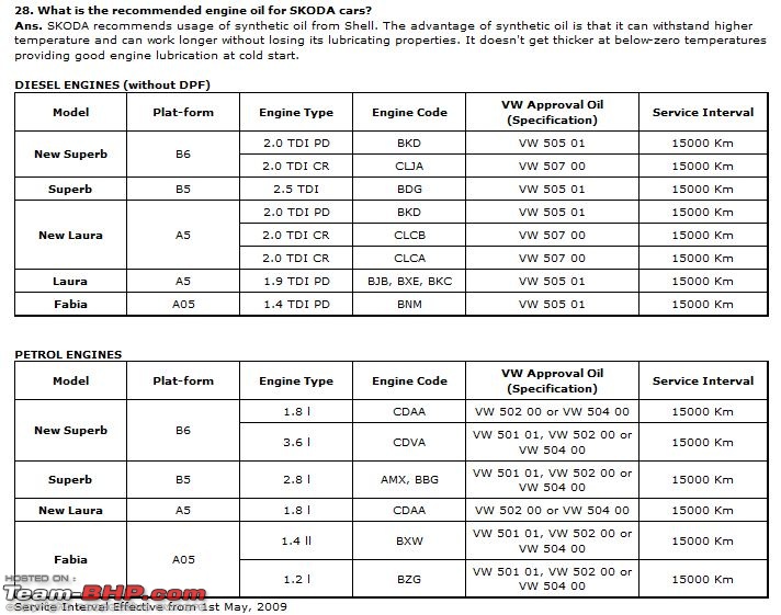

Despite all my efforts, I couldn't source VW 504 oil for my Laura TSI which is recommended by the manual. Wrote to Mobil & Shell for the same. Both responded but didn't comment directly on availability / non availability of VW 504 grade oil in India. Looks like oils are specified as per EU regulations / conditions.
Skoda A.S.S. used Castrol magnatech for top up. Not sure if one should go for Edge instead, but dealer didn't have options. Anybody aware of difference between the two?
The Engine oil recommended by Skoda for the Superb Petrol is Castrol Edge Synthetic Oil 5W40 (corresponding to VW 504 00; 4.6L capacity) and the same is also embossed on the manual cover.
Skoda / VW Group Engine Oils-superb-engine-oil.jpg
Specifications for the Laura TSI are VW 502 00 and VW 504 00. Castrol Edge 5W-40 conforms to VW 502 00, so that is the right choice. Oils that conform to VW 504 00 are the professional series in Castrol, so it's better if you could conform to VW 502 00.
