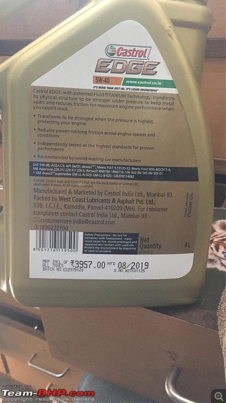

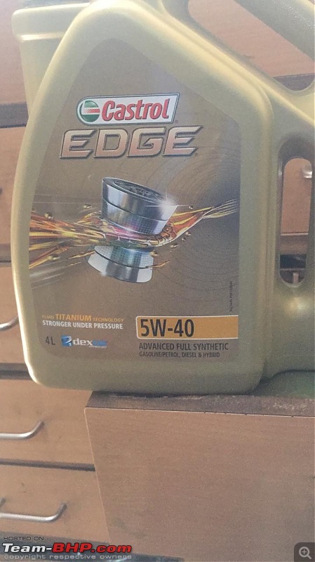

Hi All,
Thought this will be useful for all - Castrol now has fully synthetic oil which meets the VW 505 01 spec in their new 5w-40 Edge.
I found this in Mumbai and I'm happy I don't have to get stressed to find this spec of oil only through a limited channel / distribution network / manufacturer, hoping others follow suit soon!
Here's confirmation - on their website too -
https://www.castrol.com/en_gb/united...html#tab_5w-40

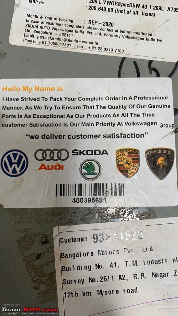

Originally Posted by AMG Power View Post
Those who follow oil specifications keenly may source your own 505.01 oil (Liqui Moly, Motul, Castrol Edge, etc).
There is no need to search outside for 505.01 engine oil. ASS uses the same grade/spec engine oil. Here are some snapshots of the labels on the Engine oil Barrel at the VW service center taken on Monday. No mention of Helix or Helix Ultra on the labels. However, clearly mentions 5w40 and VW505.00/VW505.01.

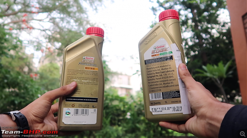

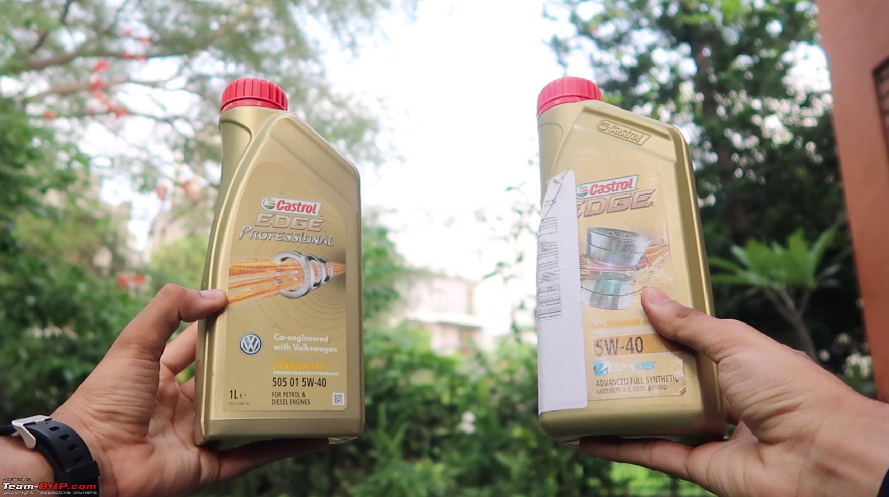

I believe Volkswagen may have multiple vendors for oil across the nation or its region depending on its tie-ups. But yes, I have also heard from multiple sources that Shell is now being supplied and its a big development to see a Shell Manufactured container. But I feel that does not necessarily imply Shell is supplying the same Helix Ultra 5W-40 to Volkswagen as well. It could well be a variation of the Shell oil meeting Volkswagen's recommendation.
