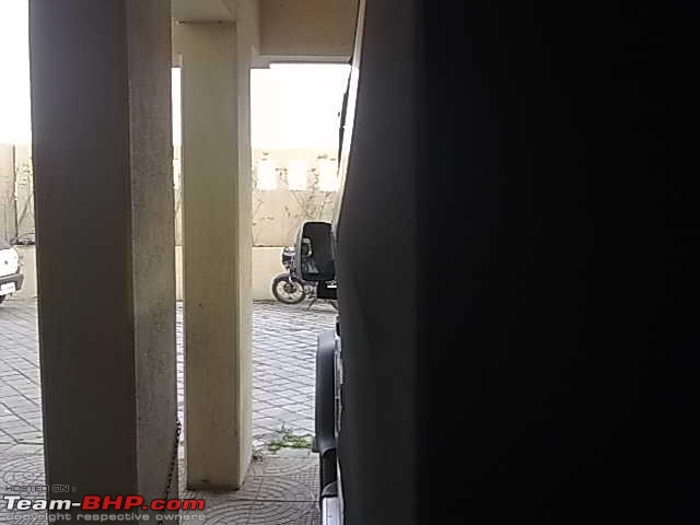

I got delivery of my Thar on 27th Dec, did PDI before taking delivery however missed the misaligned/bend rear left bench. Reported to sales guy and he sent a SA to check it at my company. The SA did some here and there and finally said that jeep have to take to service station which is around 20 kms from my place. I said him please inform the service person in detail about the issue and then give me appointment. Today I visited service center and the first reply I got from assigned attendant is "sir can you please come back on Monday" After some discussion it looked at the issue and said it will need 3/4 hrs, I said if you give me tool I can fix it in 15 minutes.
Finally after some wait jeep went in, and after around 1 hr he took me in and said the bracket (left bench is longer than right, there is bracket to support the extension behind navigator seat) is fixed at wrong position and need to relocate it but he can't do it. He want to send a snap to Mahindra and then they will reply what to do and not.
The IMP issue for me is first the misaligned seat is pushing the soft top out and it can get damaged if it can't be fixed imminently and second thing is it is looking bad. SA said if something happens to soft top it can be covered under warranty
Now I am in question that should I follow up with these ASC guys or fit it somewhere outside.
