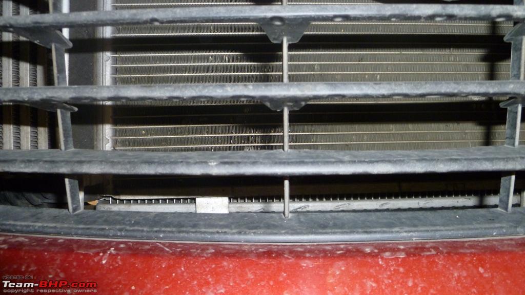

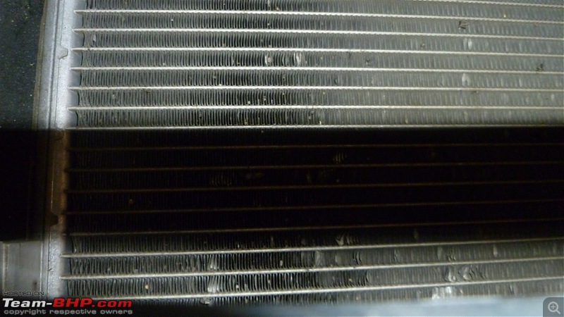

There you go guys. Please note the car is only 5 months old. And he is a little dirty because of the rains.
The Radiator
The Radiator
The Intercooler
The Radiator grille.
I thought of putting a mesh grille to help protect the fins from small stones etc on the highway. But not certain about the impact on cooling, wind noise and drag.

Thats pretty minimal bending. Loss of efficiency would be very small. But surprising how a 5 month old car managed such damage.
One thing to keep in mind is to check the radiator before and after you give your car to a workshop. That would be especially true if there is work to do around that area, like fixing AC, or in cases where engine has to be removed, etc. I suspect a careless mechanic can do way more damage than stones/pebbles in real life. In any case the bent fins in my car no way seems to have happened due to flying debris. I'm willing to wager that mechanics who did AC work or changed cross member some 3 years ago would have done this wonderful complimentary work on my car.

... I thought of putting a mesh grille to help protect the fins from small stones etc on the highway.
Hi John,
No need for any action . This damage is quite natural, and is quite common in most cars doing some 80+ speeds on the highway.
Also, IMO, there is no need to put a mesh grille.

I bought a special pliers nearly 40 years ago just for these jobs. It has flat tips like tongs and is bent like a hokey stick in front. You gently hold each fin and straighten it one by one, a pretty tedious job. Will post a picture of it later on.
Here are the pictures of the pliers described above.
In good old days the radiator repair person would laboriously straiten, each fin individually. Normally the comb type straighteners would damage the fins as you tend to hurry the job, so they used similar pliers. Recently many radiators are all aluminum and you have to be extremely careful, else the tubes get micro cracks while straightening the fins using comb like devices, which get struck if the bent is very acute and you put extra force to straighten them out.

Deetjohn's car's grill seems to be too widely spaced. Looks like bad design to me. Which car is it btw?
The widely spaced thing is the intercooler. Look at the radiator next to it. The radiator is much more tightly packed. I was running the same intercooler in Swift petrol turbo setup and it worked just great. Best thing about Swift diesel intercoolers is their price. The MGP part MRP was Rs. 1700 only when I bought it.

Not much damage and would hardly affect cooling efficiency. You can use the pliers I have shown in the previous post to straighten the fins if you are very concerned about the damage.

I think Raccoon was referring to the grille on the bumper. A mesh behind the grille will help against flying stones. Time to get in touch with josepeter I guess.

Thats not the radiator, its the AC condenser fins which are bent. The bents are very minimal though, in my car its a bit more bad.
Though, the cost that you mentioned for the intercooler is comforting. Any idea how much is the radiator? And will the aftermarket parts from MASS be as good as the factory fitted ones?
Like i said its the AC condenser fins which are bent, the radiator fins would be alright as its behind the AC condenser.
