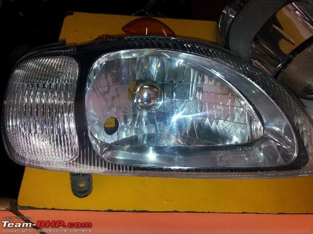

I have been having issues with my headlights on my Baleno for over a year now. It all started over a year ago when I was replacing a fused headlamp bulb on the right side. I had not put the rubber seal or boot back properly and it dropped off, while the other side was getting dull with use. This now started allowing the dust to enter in and the reflectors started getting weaker and weaker. I tried all kinda bulbs but none gave me a good view of the road, also not to forget that I have tints on the windscreen which already hampers my view. My car was also looking bad as the headlights were faded.
On many of my recent vists to JC road, I always passed by the this shop where this guy gives the lights a new lease of life. He is the only guy on JC road, who opens the lens of the lights, cleans them and buffs them. The only thing that was holding me back was removing the lights and taking them to him. Two weeks back I went to him again and he said that he could arrange for a mechanic to remove them for me, provided I pay for the labour which I agreed to as he was only charging me 100 bucks! However I told him that I will come the following weekend as I was busy.
Got some time this Sunday that went by, and went to him at 12:45. The mech removed the headlamps in about 20 minutes, and here is where the actual process begins.
He first removes the screws from the headlamps and the bulbs. The he heats the sealed area on the light with a kerosene splinter, this is done to melt the silicon gum that hold the head lamp and the lens. Once opened he wipes the reflector with a waste cloth no water is applied on the reflector for obvious reasons. While the owner is doing this his, workers are cleaning the lens with a scrub pad like the one used at home for vessals (read scotch brite type ) and the local steel wool and some soap. This actually scratches the glass all the more. I was zapped but the owner said that i will all get cleaned off as the lens will be buffed. After the cleaning the buffing is done and all the haziness is removed and the silicon is heated again and the lens is put back in place which gets sealed again once cooled. The pic below will give a better explanation.
I still haven't figured how you write a line or two below or after a pic to explain the pic, any help in this regards is welcomed!
For the time being, the first pic is of the headlight before the work started. 2 & 3 is of the lens being cleaned, 4 & 5 pics are after the cleaning. All the other pics are of the final product. I must say the visibility has improved by more than 75% and trust me thats huge in my case. 1 big mistake I made here is I did not take the pic of the driver side headlamp as that would have given you all a perfect idea of what you can expect. Oh, and the last pic if u look at the top u can see a few small blisters, these are something that this guy was referring to as air crack I guess. He said that this will not go, though not visible in the day, they can be easily noticed at night when lights are ON! Lastly, since he was anyways opening the headlamp, I did one small keeda, and asked him to remove the orange lens, as I always wanted to have white bulbs for the indicators. Something different!!
oops, I forgot the million $$ "kitna liya question." - Well, he charged me 1500 for the buffing, 100 fitting and 70 for the rubber boot. I felt it was worth the money considering a SGP headlight costs around 5k for a single unit. I think I can use them for atleast 12-15 months minimum!!
PS: I will be going to him this Sunday again as my brother wants to get his Santro done too. For the Santro he said that he has the lens available, claims its the original Lumax product. Said it will be 850 with labour, so lets see!

work looks good but charges are steep ; yes,it makes good sense only if one were to compare the job to the cost of an equivalent SGP.
The quote for Santro @850 seems reasonable
I saw a guy here who did both the L and R Corolla headlights for 1.5k.

Last pick looks completely different from the first one. Looks almost like new !

Excellent, this sure looks like a real cheap to get some life out of aging head lamps. i am thinking of getting this done in my Baleno as well. Are the lights bright now?
1500 is nothing compared to what one would pay for the replacement of the complete thing.

The same job done at kurla cst road mumbai cost not more than rs 300 per headlight for any car plus rs 100 for opening and refitting the headlights.
I feel the charges are steep but guess thats what happens in the absense of competition.

Normally an electric oven is used to heat up the headlamp unit to soften the seals before it is pried apart. Here he has used a 'kerosene splinter' - did'nt understand what that is - Blowtorch, stove or a lit kerosene dipped rag? But still it is a low cost option. Important thing is doing it without making a kebab of the headlamp.
Moral of the story: Find a need and fulfill it (while making a profit or killing of it).

Rather crude and very expensive though. The same can be done for much lesser. Also you can clean the exterior of the lens yourself instead of opening the unit. The interior of the unit only gets dirty if the seal is not proper, else it should remain clean for several years.
To do a DIY job, you need to use a rubbing compound and rub the lens surface. Use motomax 2k rubbing compound on the lens. If you're doing it by hand, plan for around 15 minutes buffing with rubbing compound per lens. The exterior defects should be removed with this process. Then comes the part of polishing it. Use a plastic polish like Meguiars PlastX to further refine the surface. You should get a brilliant shine. If you don't have PlastX or are having difficulty procuring it, then use a sealant over the lens after the first step. This should protect the lens from UV fading and dirt.

1) The glue in the headlights must not be silicone, since silicone cannot be melted and then reused. The glue must have been some sort of plastic based adhesive (like the ones used in glue guns)
2) The correct instrument to use to heat the headlight is a hot air gun, with a thin nozzle. If used properly, it will not cause any damage to the headlight.
3) Although now clean, remember the headlight no longer has a factory seal. If the seal lets air in, moisture and dust will kill the reflectors. For anybody else who is attempting this, I have a recommendation. Buy a Silicone RTV Sealant Tube. 100 gm tube should be enough and will cost you about Rs. 110 or so.
After refitting, just take silicone sealant on your finger and rub the stuff into the joint/meeting line of the two surfaces.
Silicone sealant cures in place to form a water/air/temperature proof silicone rubber gasket. If it has to be removed in the future, a blade will easily cut through the same. It is easily available in Transparent/White/Black colours.
Mostly Butyl rubber is used -available from 3M but expensive. Silicones have a higher melting point.
Many thermoplastics used in got melt glue guns though not normally used as OEM products for headlamps.
Even better to heat it up in an oven for uniform heating. The lens will come apart only if the glue is softened uniformly over the entire bonded area . Better to use a hot air gun for local area reheating.

Yes, the job is very good considering I still retain the original reflector. There is a Thailand make with the name of Koito I guess and thats 5k for a pair. Sir, even I got both the headlights done.
Thats the reason I keep looking at my headlights when the vehicle is parked, and switch to the parking light at signals to save the reflectors. Once bitten twice shy LOL.

Yes Mayank, they are brighter now. Exactly my reason for getting the job done, spend 1500 and use it even for a year, its worth it. And never know if I still have the car after that.
You said it. This guy is the only one I have come across in Bangalore. I did not wana chance doing a DIY.
I did not want to do a DIY and spoil it all the more, its the start of the month and cash inflow is there so its fine. And like I mentioned, the boot fell off a year ago, so you can imagine the dust inside after driving around 10k kms. Thanks for the instructions, am sure there will be many fellow members who would give it a shot and do a DIY. Although I am sure there are many others who do not have the time, patience etc. I put it up as I found his job good and it can help others in need.
Thanks, and will do the Silicone part soon,
