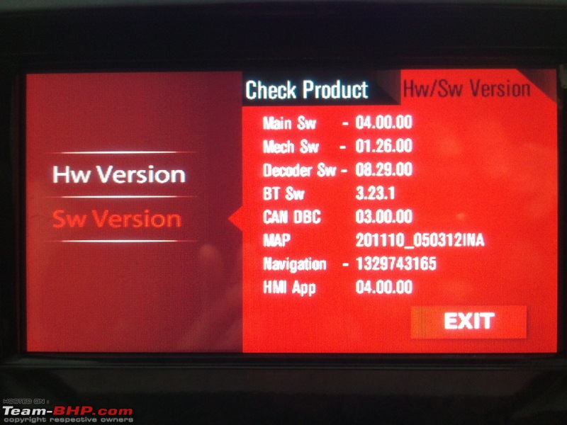

Nitin, although I have not noticed this till now, specifically tried this today. Paired my Blackberry and I could control the volume from the other party by using the rotary volume control of the main infotainment system. I don't believe its an issue with what device is paired (Samsung, BB or otherwise). Please check your BT s/w version. Mine is 3.24.7
Thanks SDP. Could you please advice how do i check s/w version?

On W8,
Mute and >>Seek pressed together gives you the firmware version details.
TA and List pressed together gives you the MapMyIndia maps version.

Update on Infotainment issue: Replaced the whole unit except the display and looks like I am turning lucky with this. No hangs , track skipping, reboots yet. Most importantly the left side channels output become same as right side. Now the whole stereo sounds much better.Thanks to my RM who helped me through this.

Here is what my version numbers after the IS replacement:

Does the XUV comes with MMI SD Card or the CD? On the SD card if you look it up on a laptop the version number is available there. On CD i have noticed there are problems in reading because of dust.

Originally Posted by SDP View Post
On W8,
Somehow I could not make this work on my W8. It just does not seem to work. nada. Either it jumps to the next track or else mutes the volume. I tried one by one, simultaneous press and release, simultaneous press, hold and then release. But no go!
I had the same problem when i tried it with the ignition on but engine was off.You need to switch on the engine for the key combo to work.
