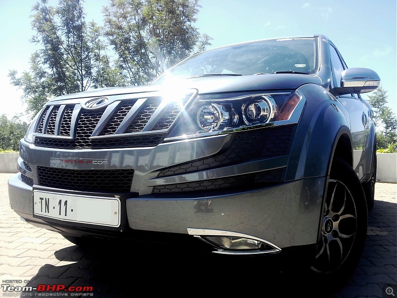

Have added another 500 kms to the ODO today. Now the ODO stands at 1500kms. Today I am in Thekkady.. saw some really worst roads and ghats which are equally worst in terms of roads. The beast took it with ease and am loving it every minute. Hope this continues.
The best part of this car is road presence and ability to cruise at 120-140 all day long. No stress or strain to the engine and the ability of the car to handle those speeds with ease. BEST HIGHWAY CRUISER among the SUV's/other cars at this price range. Mileage was 14.8km/lt.
Faced a minor problem of Front Driver side door not closing without applying firm force. Otherwise no major issues.
Anyone faced this problem.. and whats the solution to this door issue? I guess re-alignment of door must correct this issue. Will wait until the first service to get this corrected since its not a major one. Teaser pics of my car -

Congratulations and best wishes for your maiden voyage in XUV!
Is that happening always or only when you close that door as the last one? I'm living with similar problem in my Scorpio - albeit with the rear door - and I discovered that the car acts as an air tight chamber if I closed that as last, requiring firm force to get it shut properly.
After checking the hinges, rubber beading, door seals, etc., and assured that all is well, but with no remedy, here's the simple trick I resort to:
1. Open any other door and leave it ajar
2. Close the problematic door without any extra force (ahem, extra for Scorpio standards; others, please read that as super-extra).
3. Close the other door as normal (for some strange reason, the air tight phenomenon doesn't happen with other doors).
Why don't you try this trick and see if it works for you?
Cheers!

The door issue sorted by itself. Am able to close the front driver side door as I close other doors now. No issues. Mileage has been around 15 all the time.
Mileage you are getting is simply terrific for 2.2l diesel. Think, you must drive in an efficient and sedate manner..
Have added another 100kms without any issues today The brakes have set in well. Today I didn't get any grinding noise even in slow speed braking. Feel all the more confident with the machine. and the car drives and picks up faster than before.. notable difference, must be due to the engine setting in.
Awesome machine and am loving it! Compiling a review as well.
