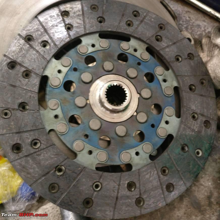

Old 23rd February 2018, 13:49   #4298
sbala's Avatar
Posts: 414
Thanked: 164 Times
Originally Posted by sbala View Post
Some updates...
For Issue #2, Vacuum Modulator/EGR got replaced under warranty. Along with this, the service guys replaced Air Filter as well. I will have to do a long test drive to find out if this has solved the issue.
A year ago , I had posted about two issues. One with the clutch and other with lack in pickup. Pickup issue was due to vacuum modulator and it got replaced under warranty.
Now, issue 1 started getting worse and as reported by many here , it's premature clutch failure. My vehicle has done 34000 kms . Sireesh Auto as usual denying to cover with under warranty.
I had given them all the references to the post here where Mahindra has honored the warranty. I have also raised a ticket with Mahindra..
Waiting to hear from them..
sbala is offline
Old 23rd February 2018, 20:39   #4299
sbala's Avatar
Posts: 414
Thanked: 164 Times
Mahindra is not willing to get this changed under warranty. They are offering 25% discount on parts and labor.
Totally disappointed with their approach. My previous car's clutch was changed at 1.07 lakhs kilometers. And all of a sudden, they are starting to held me accountable for this issue and pin pointing to my driving style.
I have also asked them to refer to my ecosense score to know about my driving.
Can you guys please let me know if you have changed the slave cylinder under warranty? I know couple of them had changed. Is there anyone else in our community? Aritra , the Mahindra customer care area manager is challenging me that this is never an issue with XUV and he doesn't believe in people reporting here.
I need to show this thread and tell them that the fact even if I don't get it covered under warranty.
sbala is offline
From your location, I am guessing you are from Bangalore. If so, do get the vehicle checked at Chrome Adugodi also. Many XUV owners in Bangalore have positive feedback from them.
However, what was the issue you were facing since past one year related to clutch ? You were noticing any difference in the way vehicle was responding?
mpksuhas is online now

Old 9th March 2018, 00:09   #4305
sbala's Avatar
Posts: 414
Thanked: 164 Times
Re: Mahindra XUV500 niggles & solutions
Engine jerking a low gears during bumper-bumper traffic was the problem i was facing for sometime. Culprit was the clutch. Its all sorted out now.
