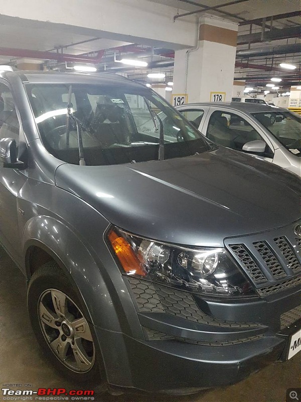

Has anybody had their wipers go kaput on them?
Was driving on the Sealink and decided to clean the windshield. Pulled the stalk and they got stuck mid screen. Screwed up visibility big time.
On the way home, I managed to push them down (with instructions on the phone from a friend who has a garage)
While I have an extended warranty, I don't think I can wait 2 weeks for an appointment to have them fixed. Any idea what could have gone?
As a primary suspect you may want to check the fuses and relay once. If they are intact then it is most likely that the switch operated by the wiper stalk has conked off. Wiper motor going kaput is a rare scenario.
