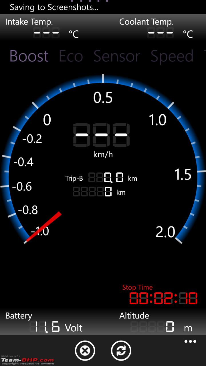

Quick question, has anyone replaced the battery yet! Any idea about the battery life for the model we have(I have Exide, if I remember it right). I have been observing that the speedo needle making another full round on a cold start, usually first time in the morning, doesn't happen later in the day. Once I also observed the IS reset during my stop/start function at a traffic signal (this happened only a couple times so far), I guess, I see the battery light glowing longer for about another second or two compared to what I used to see earlier (during cold start only), going to get more observations recorded. However, thought of checking with some of you to find out if anyone has observed such behavior! Mine is 26 months old car now @45K kilometers. EDIT: I use stop/start function about 95% of time in the city, don't use it on my highway drives.

I just connected my OBDII and used a free app to check this out. it seems, mine is not in great condition it seems. I need to check with the RM. I was expecting longer than 2 years form this battery, it seems its the start/stop which may have caused the battery to die early!! or do you think about 2 years is the life of this battery! Here are the two of them, one is recorded without engine running and the second is with engine running.

2 years is too early for a battery to die. Somehow the battery is not getting fully charged. What is the daily travel distance? How many times the engine gets cranked? While at the service center, get the alternator also checked - a bad regulator can cause less voltage, leading to low battery charging current.
