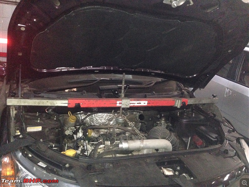

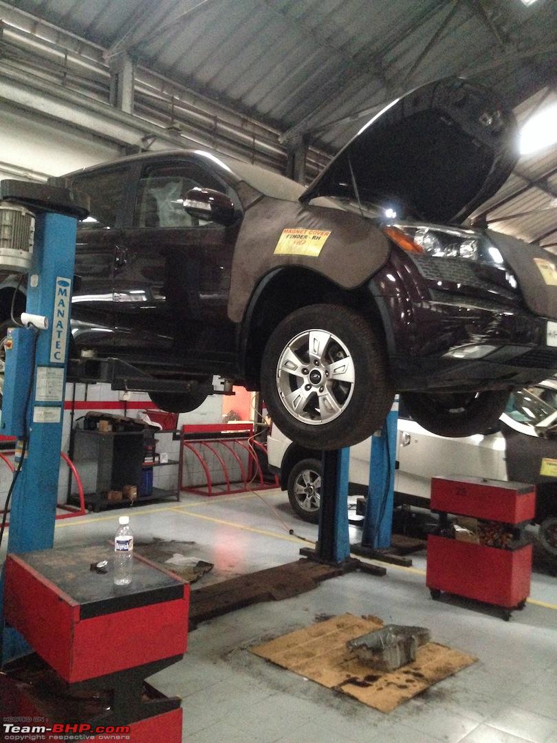

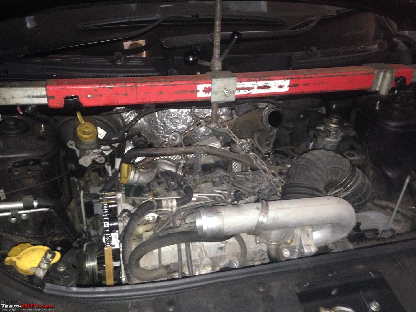

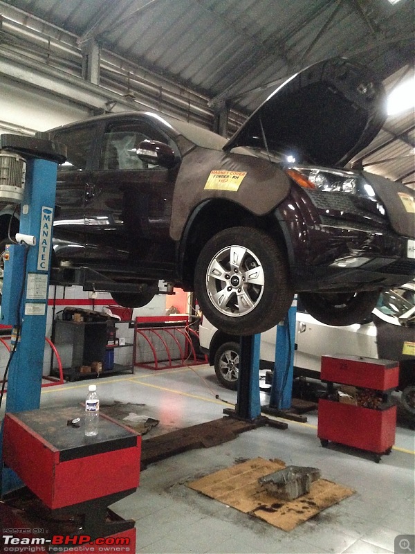

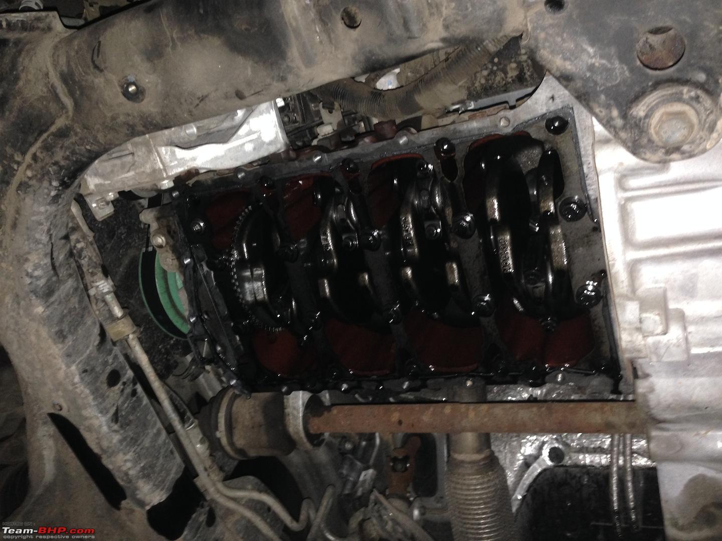

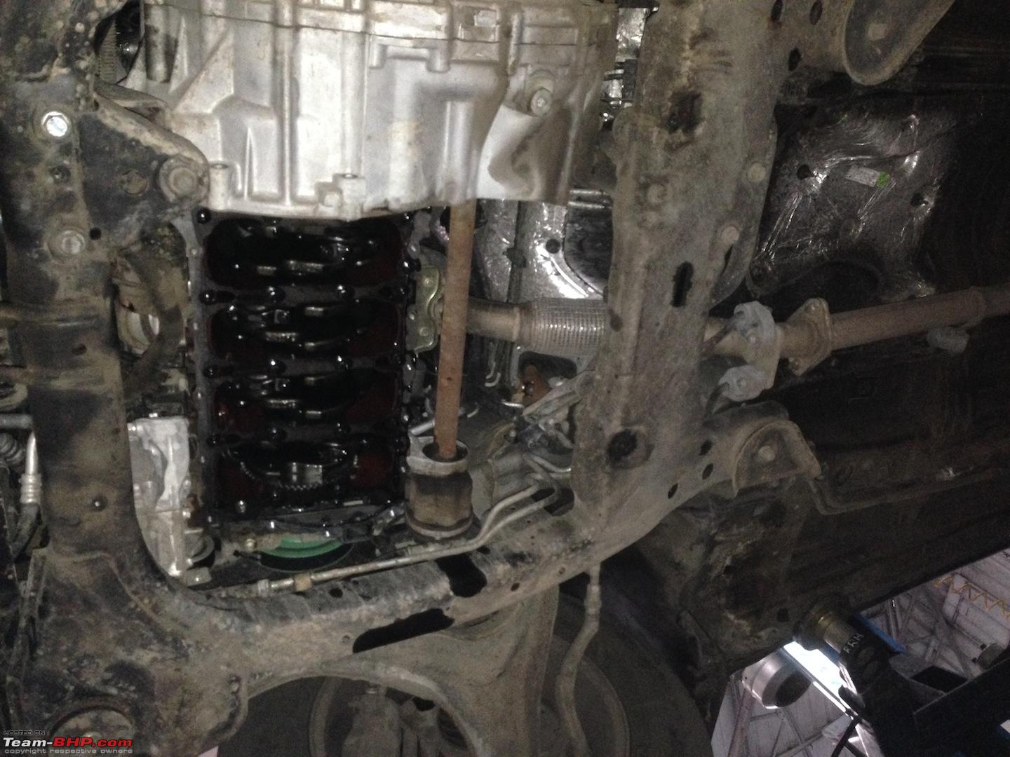

So my car is at the service station from more than 15 days now for the oil pump issue I had discussed earlier here on this thread. first they just replaced some assessory belt and were reluctant to investigate further for the problem and solve it even after repeated complains and giving them the video clip for the exact problem as it is an intermittent problem. happens most of the time but sometimes (read that as mostly when I take it to service station) doesn't show up. then as SDP suggested, I warned them that if need be I'll write to the customer care VP. then the head service manager whom they refer as Kotak, met me and I explained him about the exact issue and also showed him the Video. he assured that he'll look into the matter and do whatever it needs to solve the issue and I leave the car with them for some more time. I agreed and then after 2-3 days again I went to check the car and the work done on it. they had the opened the Oil sump to check. the pics of which are below.
(pics 1-6)
I was told by the Kotak guy that he is updates to the Plant and he'll do as they suggest him. he shares his findings and pictures with them. so he will have to wait for their revert and do as they ask.
Thanks to shrk_18, I also asked them to speak to the Guy who had worked on his car. he too had similar problem which was rectified. but my RM said that he had the issue every time the car starts. the oil lamp lit every time. but there wasn't the noise problem which I got when the car starts.
so then I visited the service station again after few days and they had removed the Oil Pump along with the timing case (which is a one unit I was told) and also checked the Top and Bottom crank shaft bearings for any damage or scorings. he said that the Top bearing had a brown layer formed which was mostly due to over heating due to the Engine oil not reaching on time because of the oil Pump issue. so mostly the Oil Pump and the Top bearing will be replaced. they had also opened the Turbo to check if there was any damage there but they didn't find anything wrong in it. they had kept the engine on hanger as they had removed the oil pump from below and so the engine needed support. shown in pics 7-10.
I also asked the Kotak, who by the way was a co-operative and helpful guy compared to the RM and others out there, that if its ok to open the engine like this and what if dust particles get inside. he said that they can open this much. if the pistons are exposed then its not good. is this correct?
then I called up again on saturday and was told that they have not yet worked further on the car and are still awaiting for the reply from the plant and if need be, someone will also make a visit from the plant to check the issue. so till now nothings been decided. they still say that they didn't find any problem, no noise or nor the oil light shows when they start the car so it is difficult for them to do anything. but I have given them the video in which the car makes a very rough noise and the Oil light stays on after the car is started for few minutes sometimes. happens almost all the time after the car is started after a nights rest or after 1-2 days. sometimes it happens even when I start the car after a few hours rest.
So as of now I am awaiting their decision and my car. looks like might take a week more at least. have already visited the service station for 4-5 times in the past 15 days now.
Thanks to SDP and shrk_18 for their help.

....so then I visited the service station again after few days and they had removed the Oil Pump along with the timing case (which is a one unit I was told) and also checked the Top and Bottom crank shaft bearings for any damage or scorings. he said that the Top bearing had a brown layer formed which was mostly due to over heating due to the Engine oil not reaching on time because of the oil Pump issue. so mostly the Oil Pump and the Top bearing will be replaced.
This is unfolding as expected.
Do you have a pic of the oil-pump and timing case?
...they had also opened the Turbo to check if there was any damage there but they didn't find anything wrong in it. ..
That's good. Don't forget to get the compression test done at the end of it all. Also get the turbo boost pressure checked to ensure correct operation of the turbo.
... so till now nothings been decided. they still say that they didn't find any problem, no noise or nor the oil light shows when they start the car so it is difficult for them to do anything. ...
I did not understand this. They found the brown film (burnt oil) on the top bearings and concluded themselves that oil is not reaching that part. So oil-pump is the issue. What else do they want to decide?
...So as of now I am awaiting their decision and my car. looks like might take a week more at least. have already visited the service station for 4-5 times in the past 15 days now.
I think, it taking too long as the plant-engineers would also be involved. Hope this gets sorted in the coming week.

No. I should have taken the pic though but it wasn't there. maybe kept inside for some checking. also They don't allow to click pics. I took these anyway.
Thanks. will definitely ask them to do that.
The Kotak guy told me about the brown film formation on the top bearings but the RM keeps on repeating the same thing again and again. "Sir we didn't find any noise here and also the engine oil light didn't stay for long in front of us so it is difficult to explain them and take further actions. humare saamne aisa kuch nahi hua sir." and the worst part is the RM and the Kotak doesn't communicate regularly about the issue and so I have to inform him what the kotak told me and found. they have a video for proof and now also they themselves have found there is an issue but still awaiting for company's guys to give a go ahead.
the Kotak said he has also reserved a oil pump for me from their stock.
The last time I visited the service centre, the kotak also informed me about the additional 2 years warranty offered by the company for some 23k after I asked him what would have been the cost to get all these things done had the car not been under warranty. to which he said he had no idea as he is a technical guy and don't know the costs of the parts. but since its a major work I think would be at least 40-50k. so I think I'll take the additional 2 years warranty and would recommend it to all XUV owners as even though the car is fantastic, its still not free from niggles and issues and not as reliable as Japanese/korean cars. will inquire next time about it more and when can it be availed the latest.

Oh Boy! MagiKrider, that's no deposit on the HLA ( Hydraulic Lash Adjusters), its an abrasion. What has happened is that due to malfunction of the oil pump, the lubrication supplied has also been affected, resulting in the bearing to heat up and start corrosion ( there's a thin film of engine oil for lubrication). Please check the residual engine oil for any metal shavings ( makes your case even stronger), and once they do the engine, ask for a compression test result, also ask for turbo functioning datum ( as SDP has suggested).Coming back, this was the cause of the engine failure in my car. And eventually a total replacement. Please go through my thread dedicated for this, for some insight. a) You are not going to pay a single penny. b) Escalate this immediately.
