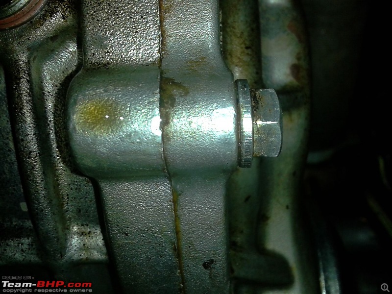

I have completed 1000kms on my XUV AWD in the first month. I had my first serious issue apart from a few rattles from the rear seat and the hat (if I can say so) of the speedo dials. There were few drops of oil below the car where ever I have parked. I did get below the car today to have a look as to where is it leaking (photos attached). I found it to be leaking from the front differential, where the right front axle comes out. The drain nut seems to be alright. I hope it is not an oil seal failure.
I don't remember coming across an oil leak problem on this thread earlier. Fixing a transmission oil leak like this could involve a lot of work if an oil seal has failed.
Please do keep us posted about rectification of this problem.
..There were few drops of oil below the car where ever I have parked. I did get below the car today to have a look as to where is it leaking (photos attached). I found it to be leaking from the front differential, where the right front axle comes out. The drain nut seems to be alright. I hope it is not an oil seal failure.
Don't want to alarm you, but that does look concerning. Please get it rectified from the service center at the earliest.
Really sorry to hear this less than a week since we personally met, when we were grinning from ear to ear, so happy with our respective XUVs. Hope it turns out to be a non-issue. If you need any help do call me.
Thanks for all the help and support Heavy Horse. It did keep my nerves calm. I was told by the Service adviser that Mr Kannan has left his position.
manipal is offline
