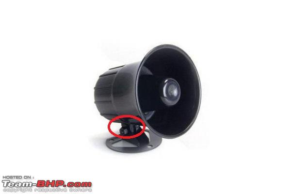

The mounting bracket made up of metal has got three bolts to secure them and it didnt come loose. Indeed the mechanic attended my car had great difficulty in removing it as the accessibility is very poor (for obvious reasons) and the screws were really tight.
The place where mounting brackets are joined with the Plastic casing of the siren is having a hinges sort of arrangement which allows an up down movement of the Siren itself without moving the mount. That part of the plastic gave up for some reason caused the device come off the original position and started hitting the alternator belt and nearby pulleys. I am attaching a sample picture with markings where it was broken. I believe the breakage happened due to some other parts of the car was constantly touching the siren which made the hinges to give up after 10 K of life.
Looking at the RM response, it appeared to me that it is a regular issue. The guy who was working on the vehicle also seems to be quite used to removing and fixing that part. Also the part was readily available.
And the funny coincidence with this part was that it was made by Nippon again. I had multiple quality issues with Nippon supplied infotainment system before.
There is no need of panic, but this can be really dangerous due to one reason. The siren has got a very powerful magnet as in our normal load speakers and due to this it was pulled by itself into the rotating pulleys nearby. Initially the plastic will protect from metal to metal contact, but after a while as in my case, the plastic worn out and the magnet started touching the pulleys when I really started noticing the sound and stopped the car. (You can notice the magnet exposed in the initial pictures posted). Luckily I heard the noise because it happened in a silent multi storied parking. But on high speed freeway cruise you may not notice this and can trigger a short circuit or spark due to high friction. Around this part, all other components are plastics / rubber (Coolant tank, radiator connect pipe, Air intake to intercooler etc), a perfect recipe for a potential fire breakout.

I spoke to the RM and Service Manager of my ASC here at Jamshedpur and learnt that :
  1. They have come across a couple of such incidents (siren coming off and rubbing against belt) here.
  2. M&M have redesigned the mounting bracket of the siren. My ASC have the modified bracket in stock and promised to change the bracket in my XUV during my next visit to the ASC.
