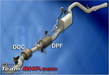

Originally Posted by vina View Post
Wouldn't getting rid of the DPF also result in the soot then reaching the CatCon and destroying that?
Umm... I think in vehicles with DPF, there is no catcon, instead its the DOC (Diesel Oxidation Catalyst). And it is placed before the DPF.
