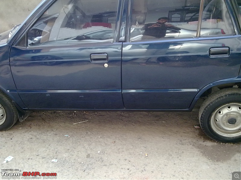

Today I finally got the time to try out the Meguiar's stuff on my M800!
And the results are amazing to say the least!
Work-log -
1. Got up early
2. As soon as the car wash guy left, i was out to assess what all should be done.
3. Finally started with the bonnet (used 'ScratchX' to treat the surface scratches and prepare the surface for wax)
Applied the liquid wax with the microfiber applicator(amazing lil' thing!) and left to dry
4. Then went on to right fender and again waxed it
5. While the wax on the fender was drying, I buffed the bonnet with a microfiber towel and the shine that came out literally had me like whoa!!
so on I completed waxing the car, part by part
The greatest thing I like about it is, that buffing requires very less effort + having a microfiber towel helps a lot.
(though my right shoulder is hurting a bit)
A funny thing happened while I was waxing the car!
The carwash guy was washing the neighbor's car then and I noticed him looking towards my M800.
when I looked at him, the expression on his face was priceless(as if thinking 'his car is shinier than the the one I have already washed')
Sorry couldn't get the 'Before waxing' pics
But I could easily see a mirror shine developing while buffing!
The reflection of the surrounding stuff which is usually seen in the window glass is so flawlessly continuous with the door sheet metal!!
(a few dents and stuff explain the irregular image)
Some pics
