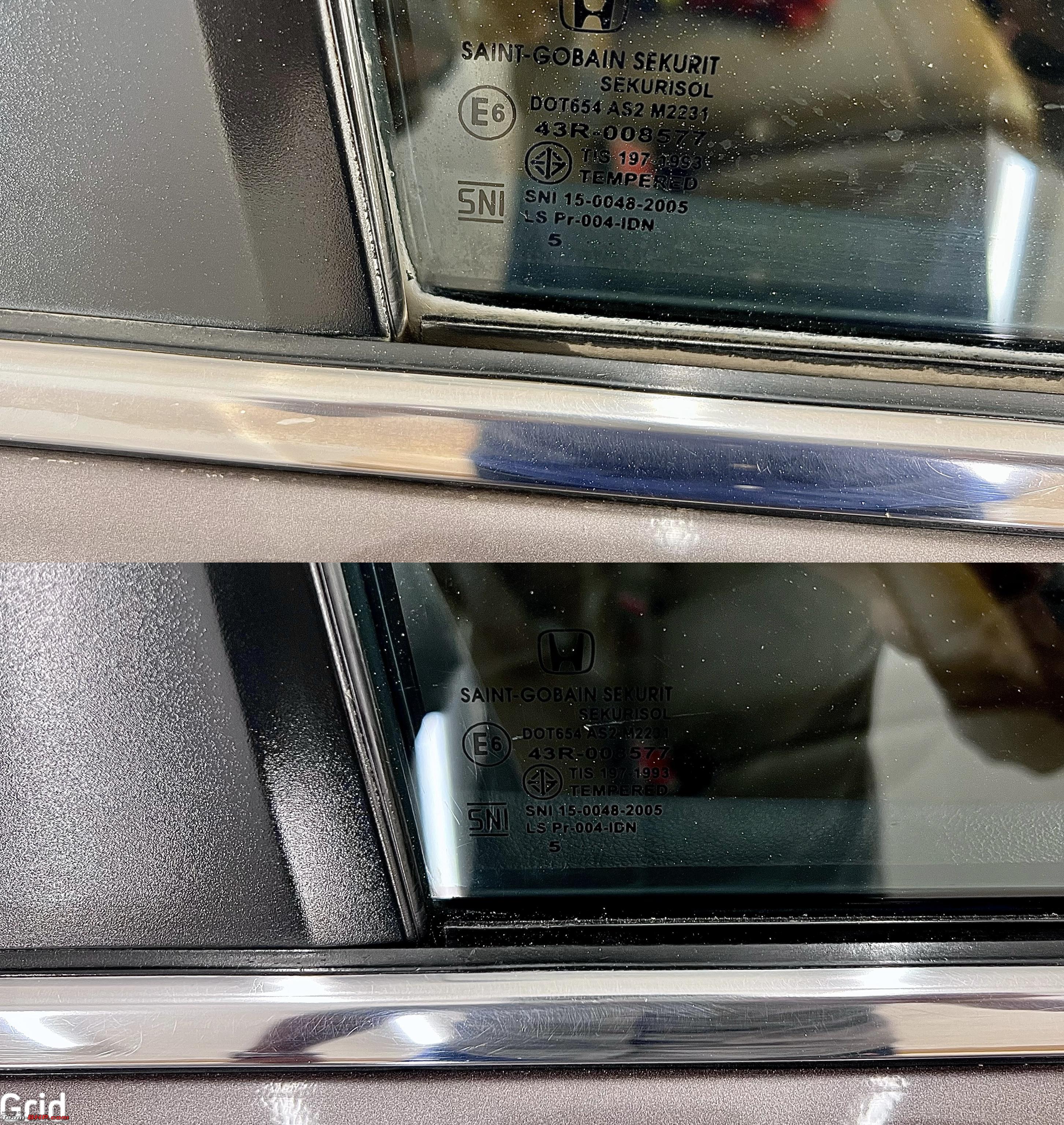

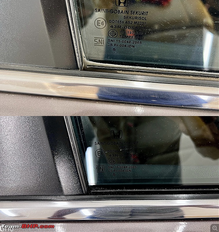

Yes hard water deposits are a major issue for cars that are not dried properly courtesy the daily cleaner.
It’s fairly easy, use a good mineral deposit remover like Puris D19 hard water spot remover. It is acidic so protect your skin and do not inhale, although it’s perfectly safe on all exterior car surfaces provided you don’t let it dry. Follow these steps:
1) Wear nitrile gloves and work in a well ventilated area/use a respirator
2) Clean the area with some quick detailer/diluted car shampoo
3) Spray onto the affected areas and use a soft brush to gently agitate, catch any drips on paint immediately.
4) Repeat if necessary, otherwise spray your shampoo/cleaner again or simply rinse with water (soft water preferably) to neutralise.
5) Apply your preferred wax/sealant to protect.
Some before and after examples of mineral deposit removers in action:

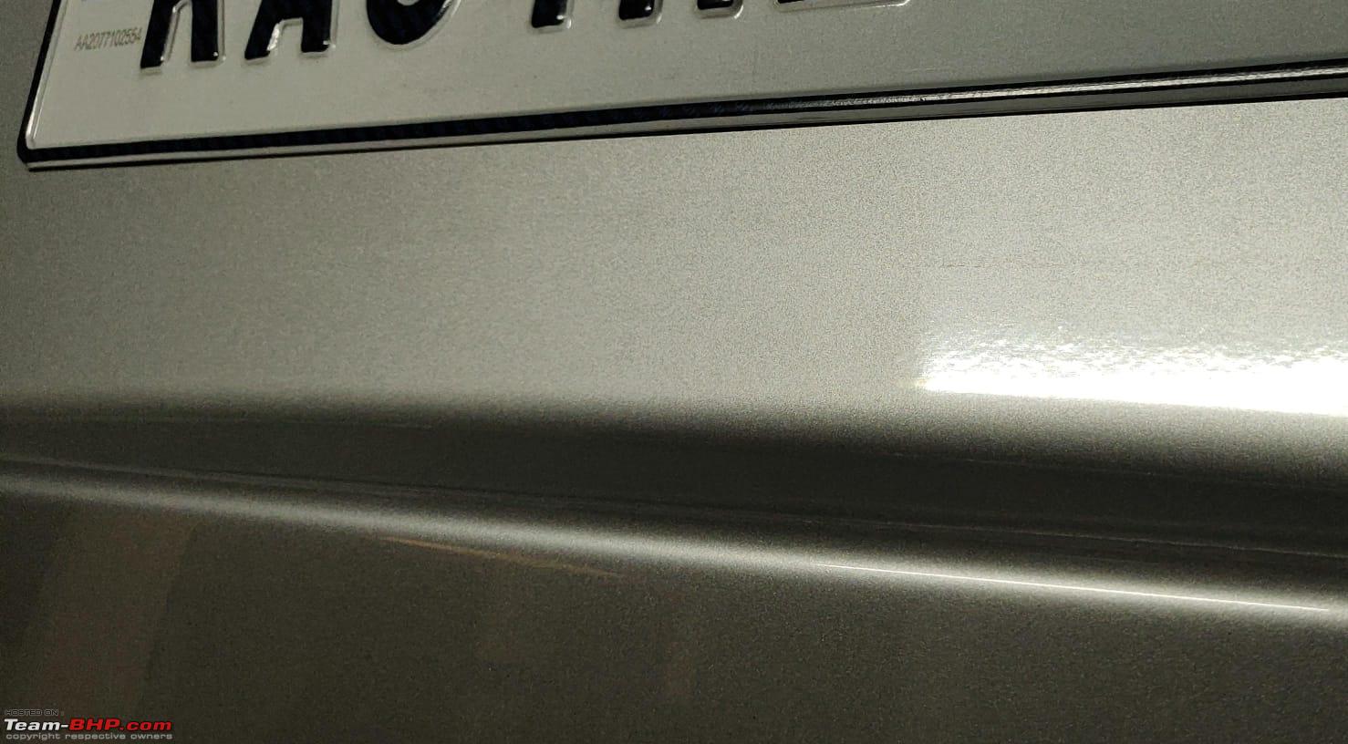

After getting the new HSRP plates, I was trying to clean the reside behind the old acrylic plate. This is 9 year old residue, which I thought was hard water deposit. There were remains of double sided tape glue, which I removed using kerosene. The surface is smooth now, slightly rough asking the dark line. I tried diluted vinegar but did not go away. Any suggestions on how to remove it?

99% of the grime removed. Directly applied Harpic over the the deposit and left it for 10 minutes and rubbed it off. It was really hard and it took a multiple tries to clear it. Thanks to our resident expert @sunnyboi for the suggestion.
A superb Car cleaning, polishing & detailing guide-whatsapp-image-20231101-3.17.50-pm.jpeg
A superb Car cleaning, polishing & detailing guide-whatsapp-image-20231101-3.28.05-pm.jpeg
Please don’t use bathroom cleaners on paint, they are extremely acidic and corrosive and will damage your clearcoat.
For hard water etching, use a purpose made mineral deposit remover like Puris D19. If some is still left, follow through with a light cut polish with mild abrasives like Menzerna 3000 and you’ll be done.
