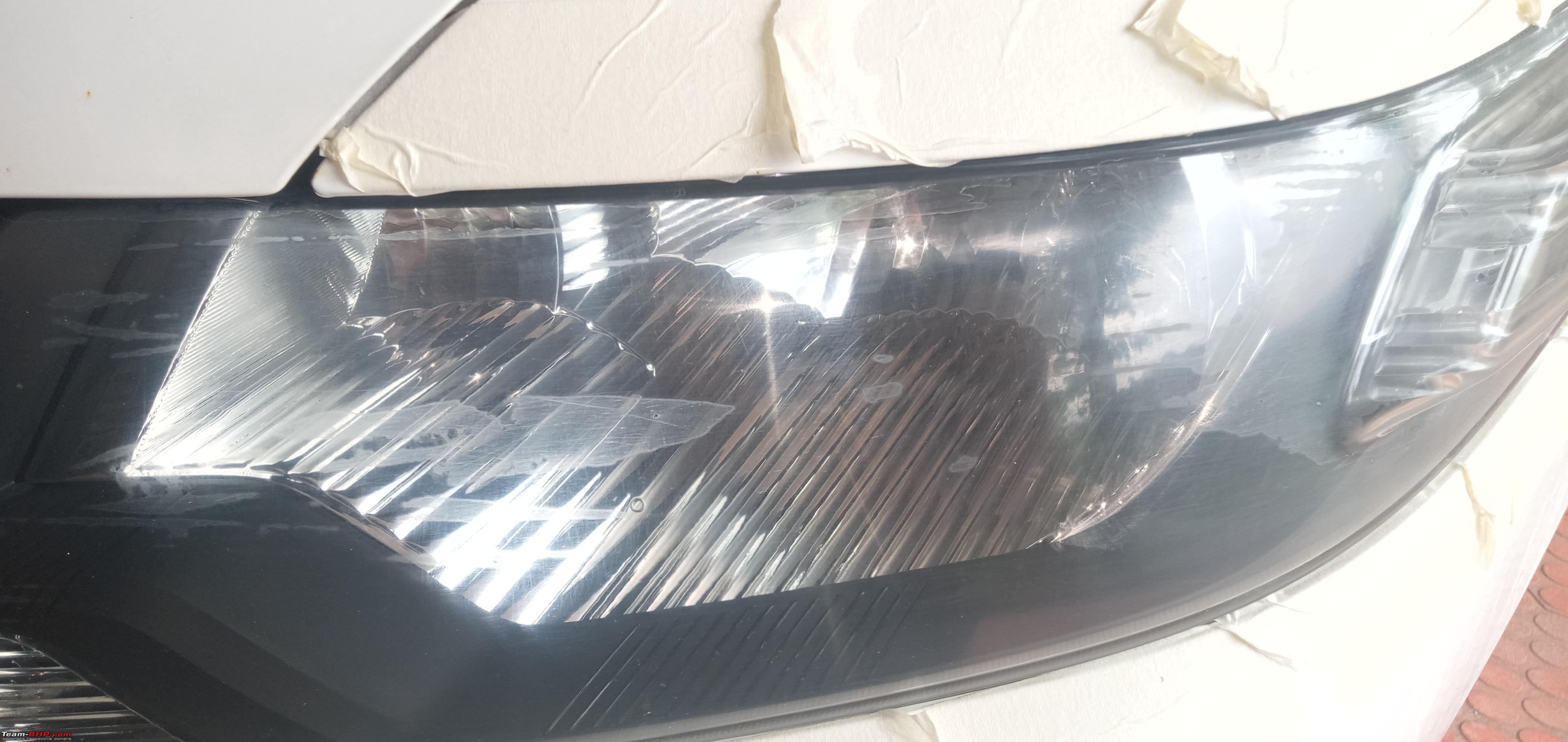

I used the Turtle wax headlight lens restorer kit on my Honda City and I am not sure If I messed up or got the existing defects on the headlight to pop out more.
Attached images. There seems to be some clear coat peeling away from the headlight. This has been there since I got the car but I think it has now become more prominent since I used the kit.
I plan to get some decent sandpaper (400, 600 and 2000 grit...following Chrisfix on Youtube) and make another attempt on both the lights. Would that solve this issue?
I have only seen headlights with yellowed plastic or just a general haze on them. Mine seems to have some of the clear coat peeling off at specific points (not sure if the previous owner had already tried to restore the headlight and used some cheap clear coat) and I just wanted to check opinions here before I proceed.

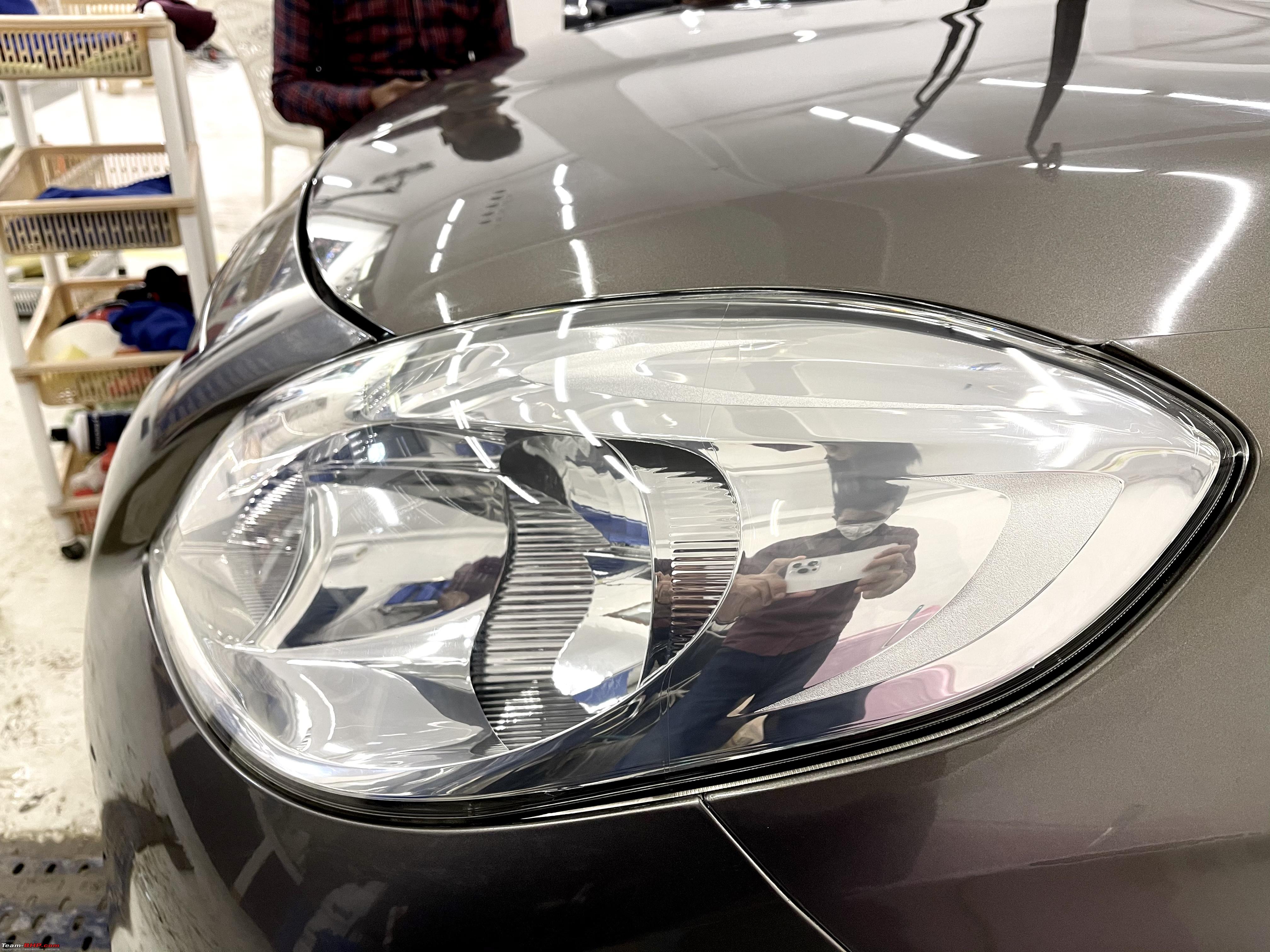

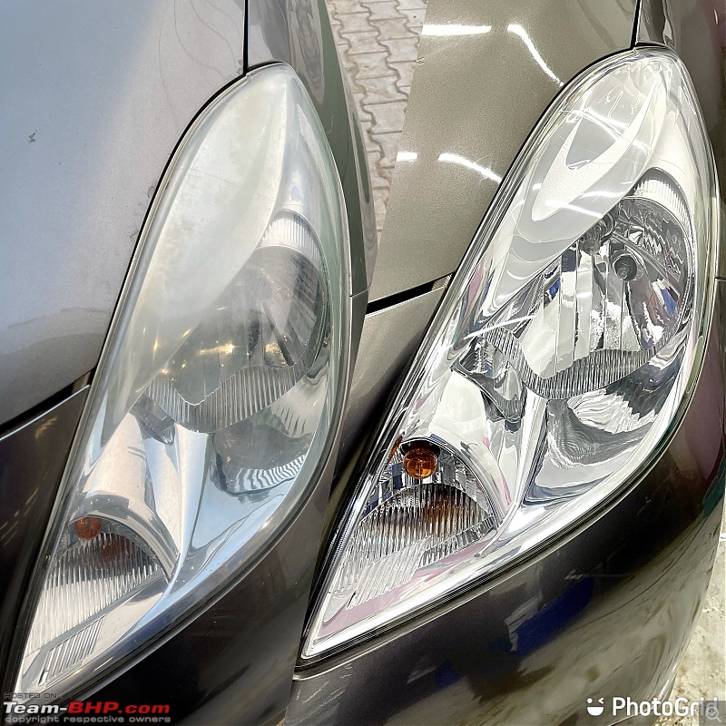

All lights are clearcoated from the factory, over time this breaks down and turns yellow, if you don’t wetsand properly you will see cloudy patches of the old clearcoat on the lens. Here’s the process I follow-
1) Wipe down each lens with some waterless wash to remove dust.
2) Clay each lens to remove bonded contaminants and mask around the edges
3) Wetsand with 600 grit sanding discs attached to a short throw orbital sander.
4) Step up to 1200 grit discs
5) Step up to 2500 grit discs
6) Heavy cut compound (Mezerna 400)
with 3" coarse foam pad on a rotary polisher.
7) Finish out with a soft cut pad and Menzerna 3500 polish.
8) 25% IPA wipe each lens to remove polishing oils
9) 2 Coats of any high quality ceramic coating (Carpro CQuartz UK 3 for eg.) applied (1.5 hrs between each coat).
If your lights are not as bad you can start with 800 grit, or in case they're worse you might need 400 grit, rule of thumb when stepping up grit numbers is to double your current number so for eg. if you're using 1500 then the next step is 3000 grit.
Here’s what it should look like after the steps above-
