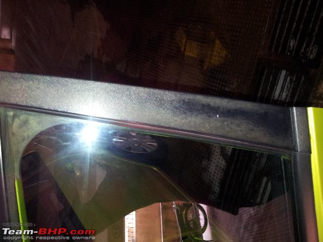

So three days back, I did a wash on my car to remove all the mud and muck from all the puddles accumulated over the past week due to Bangalore rains.
My other intention of this test was to see how previously applied P.E.R.L would stand up to a pressure wash. It had been applied on all my plastic trim at 1:3 dilution and in three coats - a thick base coat and two thinner top coats.
So, used Hyperwash which is my usual wash shampoo to foam the car and then pressure wash it down. After drying the car this is what I saw -

The last picture of my engine bay that has been detailed in the month of March using hyperdresser and still going strong.
Frankly, HyperDresser is far more durable than P.E.R.L - atleast it lasts for a month on my tyres including frequent weekly washes . I top it up monthly with 1:4 dilutions.
However Hyperdresser cannot do what P.E.R.L did to my plastic trim and that is restore it to its original blackness. But P.E.R.L fails in durability with pressure washing and this was using medium pressure. Havent tried it under direct rainfall as most of my driving was only when the rains would stop.
I shall continue to use hyperdresser on the tyres and engine bay and perhaps this shall remain as my goto dresser.
Ive come to the conclusion that P.E.R.L will continue to be used only on my plastic trims but less frequently as its like an expensive evening dress. When its on the trim its amazing but isnt durable. My search for that perfect trim restorer still continues...

Very valid observation partha. I had also applied PERL once. And it got washed off in a similar fashion. Indian conditions are very unforgiving on these products i believe. Be it sealant or dresser! But i have observed Megs Ultimate protectant to last longer than Perl!

Yes absolutely agree with you on that. The products work well in the pollution free dirt free environments of the other countries. Slowly Im loving the Meguiars line of products as not only they are vfm but they work. Hyperdresser has lasted me long on the tyres even with the muddy roads, after a wash the tyre looks just freshly dressed. But I tend to top it up every month mainly because this Hyperdresser doesnt seem to get over from my stock lol.
I had bought only 250ml of it from Mr. Nirmal, and only one 500ml (1:4) bottle has been used up with my forceful usage. Same is going to be the story with the glass cleaner and ONR. Though Ive now devised a way to use up the ONR more quickly
However I have been happy with my sealant. Had applied it in March and its still going strong - as in there is very little water left on the doors and vertical panels and the sliding bonnet after a wash which eases up the drying process. And this is with a pressure washer from the past month and the sealants and collinite havent budged. Had applied sealant and collinite separately on different panels of my car. The bonnet had 50/50 of them and both sides bead well.
Does Meguiars Ultimate protectant restore faded trim? Nothing feeds the plastic as well as P.E.R.L but then that is all it does.

Nothing can 'restore' a faded /whitened trim. Its only how long can the product hide it. And i found the megs one to be better.Anyway, i like matt finish products compared to glossy ones. So PERL was not to my taste anyway
The other alternatives are:
1. Cquartz Dlux which is a coating for the trim and should last long
2. Painting the panels with forever black.
3. Plasti-dip which can be easily peeled off. I think someone had posted a thread about it a few weeks back. That will be my ultimate option as the car's trim looks horrible as you can see in the pictures.
Yes neither do I like glossy finishes and therefore use the Hyperdresser at 1:4 for that matte look. But yes P.E.R.L borders more towards the glossy side thus I prefer to use it only for my trim.
