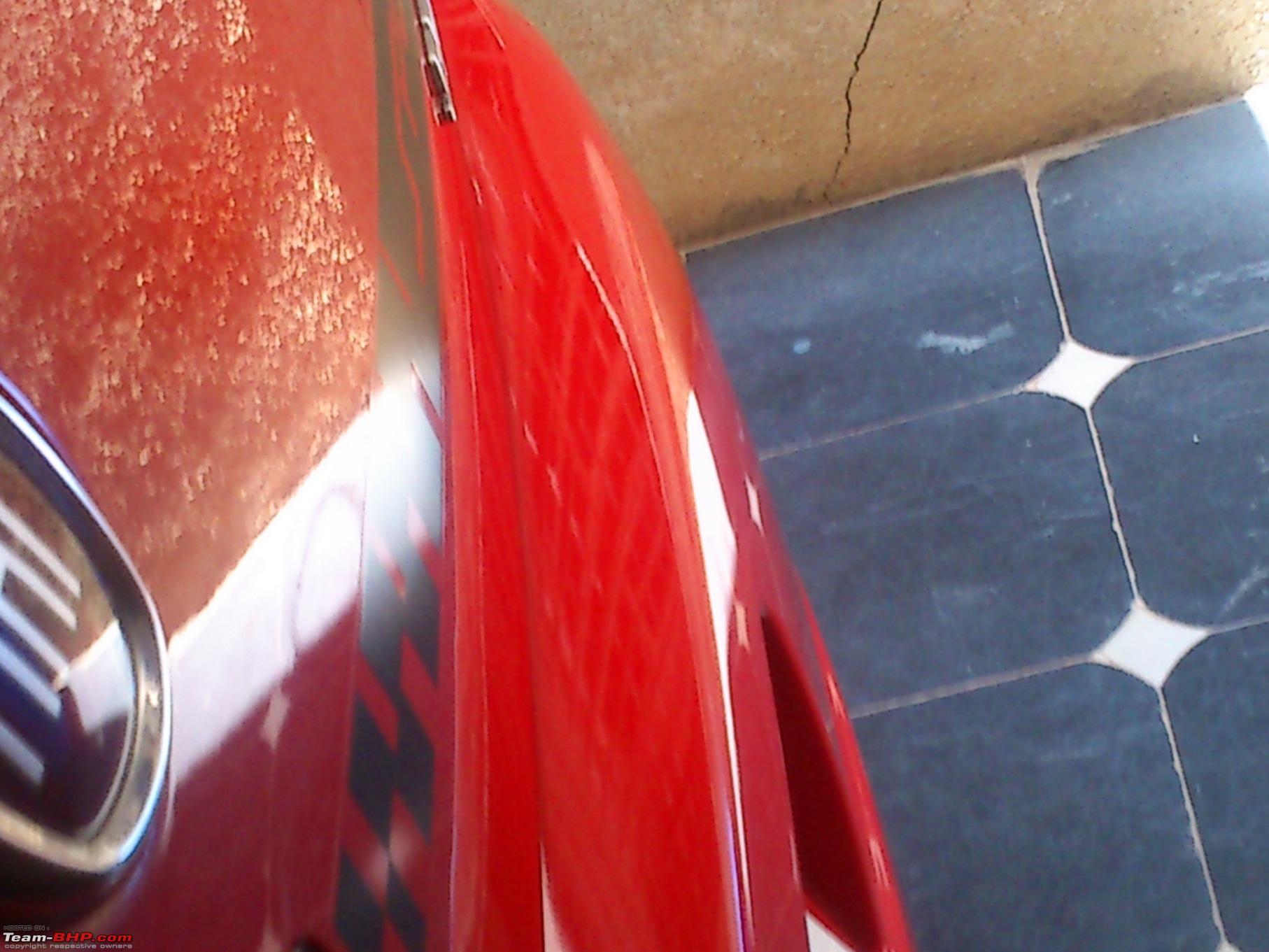

This is my Red hot Punto.
Products uses:- a) UWW ( Rinse/water less wash )
b) Mothers Clay bar kit
c) Dodo Juice micro prime
d) UPGP sealant ( 3 Coats )
e) Bouncer's Capture the Rapture carnauba wax ( 1 Coat, Planning two more coats of the same )
f) WolfGang applicator pad ( Hand applicator )

Looking good mate.
How did you prep the paint - Micro Prime on Wolfgang Tri Foam Applicator by hand? Which side of the applicator did you use?

Thanks mate, Used the orange side of it.

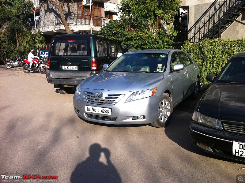

Hi All,
I am new to this thread. This is a really valuable thread. I am planning to start doing Detailing of my cars myself from now on. I am looking forward to a lot of advice from all you Car Care Gurus out here.
I have a the following cars, and I am attaching a few pictures of these.
1. Silver Camry 2007, last got a Exterior and Interior Enrichment at the Toyota Service Center during the 50K Service a year ago.
2. Dark Green Scorpio 2003 Non-CRDE
I have a car cleaner who does a bucket wash for my cars everyday.
I stay in a DDA flat in Delhi, and I have no choice but to park my cars in the sun. Over the last 10 yrs the Clear of the Roof of my Scorpio started peeling off, and the color was fading, so I got the roof painted. Now the same is happening with the Bonnet of the Scorpio.
Due to the sun, the Roof and the Bonnet of my Cielo (Now sold) had also faded over time. You can see the Cielo with the faded bonnet in the second last picture taken a couple of months ago before I sold it off.
Sometimes I feel I just cover my Camry with covers and not open it at all in the extreme Delhi Summer Months of May and June :(
Is there something I can do (I mean Sunscreen type of polish) to minimize the damage to my cars from the Sun ? My Camry's paint is not effected till now.
Now during the Spring season I run into a big problem. There are a mysterious yellow droppings all over my cars. For the life of me I cannot find out what causes these. Even though my Cars do not stand directly under a tree, I suspect these are droppings from something in the surrounding trees. These cannot even be wiped off with a damp cloth, rather they have to be scratched out with the nail. Does anybody else face this problem? Any idea what these could be ?
Now that I have decided to spend my Sundays caring for my car, I have two options. Either I can call some professional Car Detailing people to my place and get My Cars Shampooed, Clayarred , Polished or do it myself. I don't mind doing it myself, as it will give me a good weekend workout too.
I have gone through the last many pages of the thread and got the basic hang of what I need to do and get (Claybar, Shampoo, i.e.Collinite waxes etc) to get my cars back to their glory.
Now I have a few questions for the experts here
Originally Posted by linuxmanju View Post
The steps for a full detailing as I understand is.
1) Wash
2) Dry
3) Clay
4) Polish
5) Selant
6) LSP
But if your car is already in good condition you do not need to clay it for regular maintenance. Just wash it and apply wax. The above prep you might have to do it only once in a year or 6 months to prep the paint.
However you can use the clay to remove tar/tree saps often only on the affected area ( Not full car ) as and when required. Do remember that, it is recommended to do a polish after claying as claying might mar the paint and polishing it will take care of that.
I Understand the basic steps for Exterior Detailing wouuld be these mentioned above by linuxmanju.
1. What is LSP ?
2. Can somebody recommend good products which could be easily available in Delhi for each step.
Somebody mentioned Amway spray bottles from Mr. Nirmal and Claybar from notorious. How do I get the contact info of Mr Nirmal and Notorious. Can I buy these things from any shop in Delhi ?
Also if you look at the Scorpio, the first Plastic Panel which was replaced looks dark, the rest have faded away. Is there something that can be done to get the plastic panels to even colors.

Lsp is the last step protection you use after paint correction , it may be some wax or sealent.
as far as that side cadding / Bumper is concerned , no polish will bring back the original colour. i suggest you to paint them in dark grey and your car will look great.

1. What is LSP ?
LSP is last step/stage protection ( http://www.autopia.org/forum/car-det...-lsp-mean.html ). It can be your sealant, wax or whatever goes as the final step of your detailing.
You can try sourcing from BBImpex ( http://www.bringingbest.com/ ) or local Meguires/3M outlets.
The products that you might need is as below, with few suggestions.
1) ClayBar and Lube ( Check with Notorious or Nirmal or Megs also have some good clay bar and lube ).
2) Polish and Applicator pad ( Meguiar's Ultimate Polish or Compound and Megs yellow applicator pads ).
3) MicroFiber Clothes ( Something from Megs or Euro MF clothes from BBImpex ).
4) Sealant ( UPGP , CarPro Reload or Collinite 845 can be sourced from BBImpex , Nirmal or Moshin ). What ever sealant you use, it is recommended to layer it at least twice with a gap of 24 Hours.
5)Optionally Wax as LSP to keep that shine ( Any good carnauba wax like C 476 or 915 or Megs techwax paste/liquid should do it )
You can even buy a spray bottle from your local Shell petrol bunks. Nirmal can be reached at "+91 Nine Nine 161 two 0 561".
Try Forever Black from BBImpex ( http://www.bringingbest.com/Forever_Black.html) or Optimum tyre gel (http://www.optimumcarcare.com/obtgel.php )
@Pedaltothefloor or Others anything I left out please add?.

No Use , I have tried it. Trust Me !
Painting is a far far better solution then this one.
