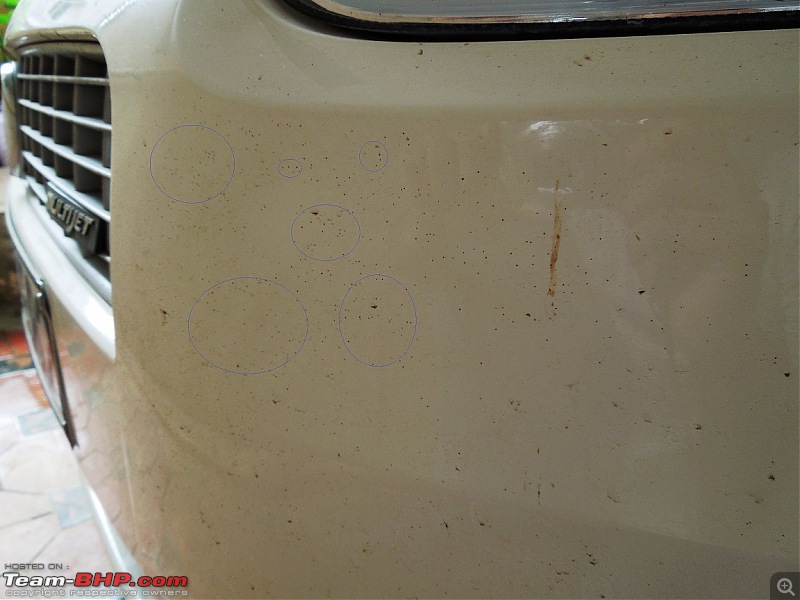

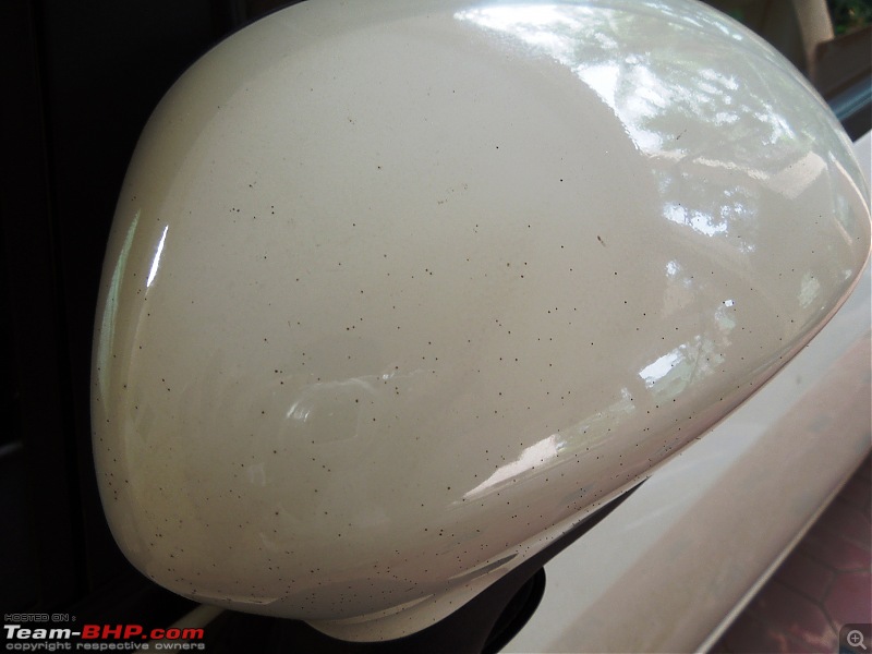

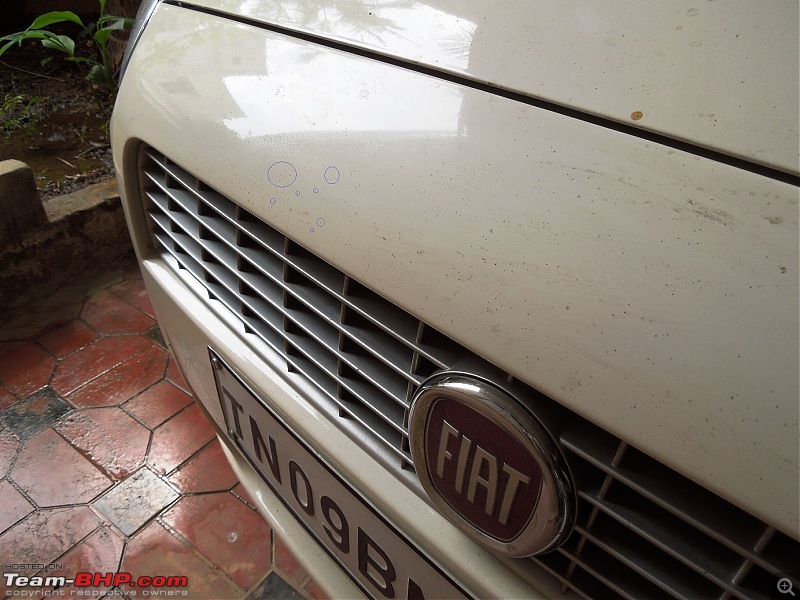

Originally Posted by Mortis View Post
It could be tar spots. Try using WD 40 spray on it to see if they dissolve. If they do then clean as much of them as you can with it. Follow with a was h with car shampoo and then claying. Thsi should take care of most of it if it is tar spots. They claying will help if it is paint overspray
Hi Mortis, Uploading the pictures for your reference. Kindly provide your inputs by looking at it to assess whether it could be tar spots are something else, the cleaners are for sure not taking any responsibility for what has happened.

Sriram : I am almost 100% sure its tar spots from the brown smudges that they have produced. Go ahead and clean with WD40. WD40 helps with paint also to some extent so go ahead with this.
Spray WD 40 liberally, allow it to dissolve the tar. Wash immediately with a car shampoo
Your solution would be a claybar. You will need to clay the surface to get rid of the contaminants bonded to the surface. You would need a Meguiars claybar costing Rs. 495 from BBImpex and Meguiars Quik Detailer as claybar lubricant Rs 300 from a 3M Car Care center.
