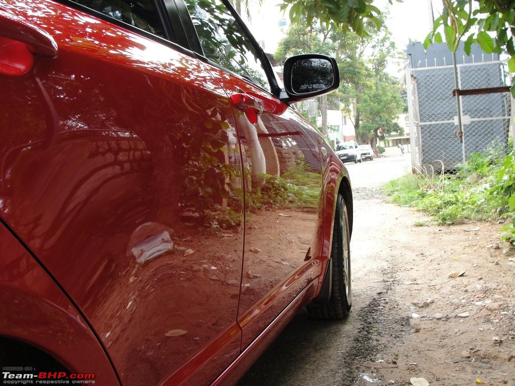

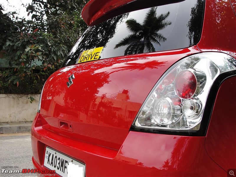

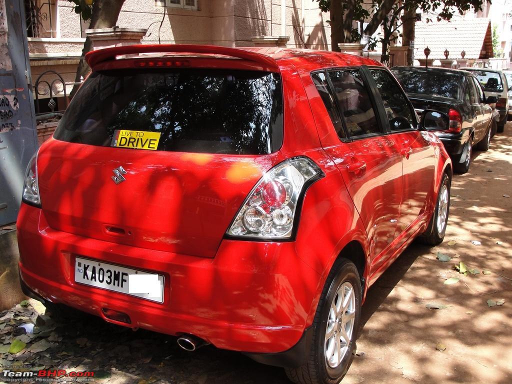

Here are the pictures post complete paint correction with my Flex DA !
Process followed :
- Washdown with Sonax gloss shampoo & Megs MF mitt
- Clayed with Megs clay & Optimum no rinse in clay lube dilution
- Megs 105 with Lake country 6.5 inch orange CCS pads
- Megs 205 with Lake country 6.5 inch orange CCS pads
- 2 coats of Megs NXT 2.0 cured for 24 hrs each
- 1 coat of Collinite 845
- Alloys washed, clayed, sealed with NXT 2.0 topped off with Collinite 845
- Tires cleaned with Sonax shampoo, dressed with Megs endurance tire gel
- Exterior plastics & wiper arms treated with Megs Ultimate protectant
The earlier pics of the test spot that i had done :
http://www.team-bhp.com/forum/modifi...-home-239.html
Thanks to all the gurus & Sohail/Garipagol for the valuable inputs !!

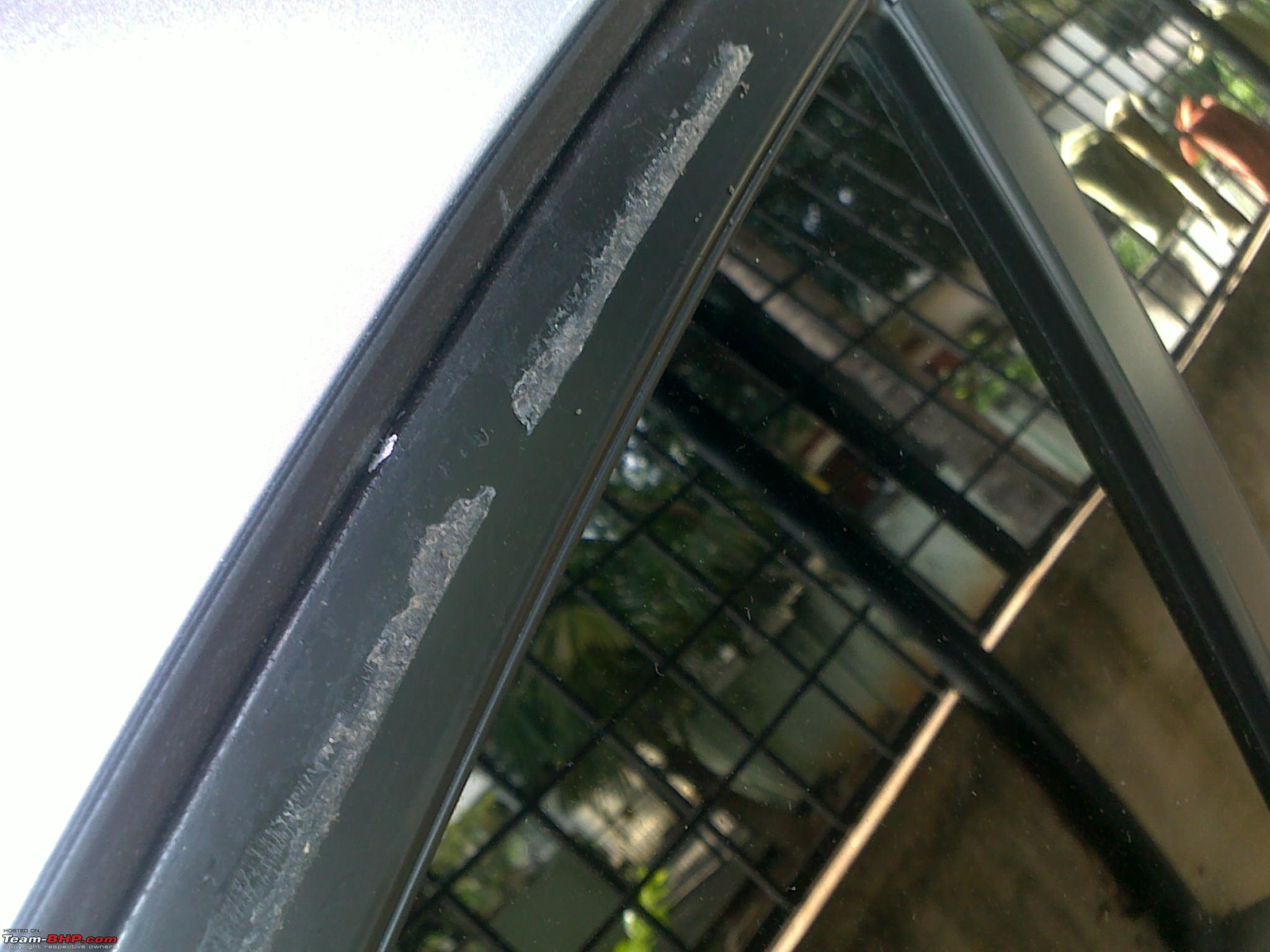

i had got the window visors fixed to my CITY. The RH , rear visor came off leaving a very bad patch of glue. I am finding it very difficult to remove and its looking very bad. Infact i am planning to remove the remaining 3 visors. I have attached the pictures.
Can anyone suggest how i remove the glue patch ? and the remaining 3 visors. The glue patch is very tough to be removed. I tried just to scrap it with my fingers. It is simply not coming out. I am worried that the paint surface may end up having bad scratches, which i want to avoid.

Hi nandans2005,
You could try out the idea that my friend did when his visor and door moulding came off.
Soak the sticker part with kerosene and leave it for some time. Try removing it gently with a plastic spatula like thing (it should not be sharp) and it will come off easily.
Try this with one area and check.
Other idea would be use a hot air blower (like the ones used for shrink wrapping) to just sufficiently heat the portion and peel it off. The residue can be wiped off with kerosene. You will have to be careful though with this method.
There was no paint damage with both the options.
You might need to wash and polish/wax the cleaned area again.
Hope this helps.

Thanks KA18 ! I didn't click any close ups of the tires yesterday, & now they're a bit muddy from driving around yesterday, will post sum pics soon post another cleaning !

Try soaking the area with isopropyl alcohol to dissolve the gummy residue.
Apply some on a paper towel or cloth & let it remain on the surface soaking in. Ive tried it to remove sticker gum left behind when removing stickers from glass, or any adhesive remover should do the job.
If this doesn't work, carefully try other more aggressive options !

Thanks Samsag ! Yup, i chose that design on tail lamps because of the sporty look they gave along with the rear spoiler. I just clayed all the glasses & keep them clean with regular Colin spray !

Thanks Nandan ! Well, i started & completed the entire car on a single day, around 5 hours (that's the compounding & polishing, followed by the 1st coat of NXt sealant) I didn't use it for 3 days to fully allow the layers to cure.
I wouldn't be able to calculate how much this would cost as ive been getting a lot of stuff down from Autogeek !!
