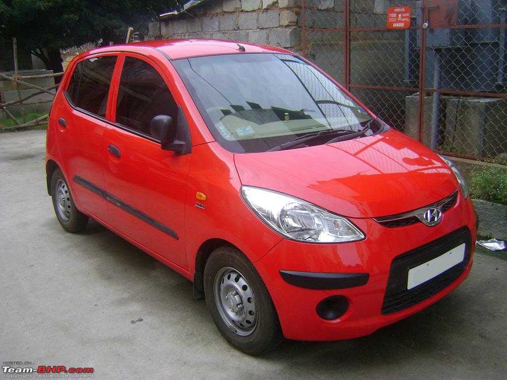

As promised, I applied the Formula1 wax on my car today.
I woke up at 5:30 in the morning.
I don't have a covered parking, so I wanted to finish the job before the sun comes up. Thankfully, the weather is cloudy today.
I am satisfied with the results, considering its my first attempt. The paint surface has developed a nice glossy mirror finish after the wax job.
Here are the results.
Rohan

Rohan the i10 looks good, how old is it?
Next time, detail the wheels and tires as well, that will further transform the look!
abhipuru16 is offline
Thanks. The i10 is 1 year and 8 months old.
I am too lazy to detail the car tyres. I am the kind of person who feels that the tyres are meant to be dirty.
I concentrate my efforts only on the paint and glass areas of the car. Most people won't notice the tyres anyway.
Rohan
