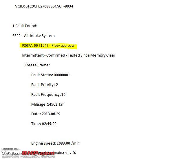

Originally Posted by vishy76 View Post
Check engine lights can indicate something major or something very minor too.
Originally Posted by nova9 View Post
Anybody have any ideas, and is this an indicator of some serious problem?
I connected my VCDS cable to the car and this is the info I got (All copied to MS word, please ignore the date; I don't know where it fetched the date from). It said 'flow too low'; I gave a quick call to my service adviser and shared a snapshot with him over whatsapp. All he told was "throttle body cleaning may be required, bring the car to station". Although the light disappeared next morning (Oh yeah, it came twice and disappeared itself both the times), still I went to a close friend. We opened the air filter, cleaned it. Then opened the throttle body leading air circuit and cleaned the throttle body by spraying WD40. Since then, the car has already covered over a thousand kilometers (Odo now has 16,400+), but no issues at all.
VW Polo - Maintenance and Service cost and dos/don'ts-vcs.jpg
