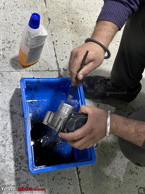

I have had several instances of Check Engine light showing up in my Ameo 1.2MPI without any noticeable change in car's behavior. This was until I got the throttle cleaning done during the annual service in January.
When the car was scanned during service, the error code clearly showed 'Air Intake too low'. The throttle body was taken out and the carbon deposits (that had accumulated over the time) were easily visible on it. The body was cleaned with petrol and then sprayed with some chemical mix to make it shine as new. Needless to say, the check engine light hasn't popped up again after this.
The service technician advised to avoid driving the car at low RPMs for too long. This will prevent the carbon particles to accumulate on the throttle.
Take a look at the carbon deposit that was cleaned out using petrol and a small brush -
VW Polo - Maintenance and Service cost and dos/don'ts-file_000.jpeg

Re: VW Polo - Maintenance and Service cost and dos/don'ts
Thanks. Do you remember the fault code?
I'm getting the following fault code in Torque pro.
P0068 MAP/MAF - Throttle Position Correlation
A quick google search reveals the following.
"disparity exists between the computer's sensors as to the volume of air entering the intake manifold."
Anyone aware of this in a VW Polo 1.2MPI?
WhiteFang is offline

I do not remember the fault code I got, but the code you mentioned seems related to throttle intake only.
You can try getting the throttle body checked at your FNG or VW service centre.
If it’s indeed due to low air intake, you can get the throttle cleaned.

A P0068 is a so called generic code, which means that all cars with an OBD onboard are likely to have this implemented.
There are multiple reason why this code can appear, not just the throttle body.
If you have an OBD code and want to know a bit more pop it into something like this:
https://www.obd-codes.com/p0068
There are quite a few of these sites, but I find this one pretty good and comprehensive.
It describes the code, causes, diagnostic steps and possible solutions.
I have been promoting proper diagnosing techniques ever since I joined TeamBHP 10 years ago. Don’t start swapping parts without proper diagnosis. As this example shows, there could be at least 10 different causes, including, but not limited to the throttle body.
Have a look at the section for diagnosing: A lot of the initial trouble shoot checks are very simple. Its about finding potential air/vacuum leaks, checking electrical connections etc. Very simple, very fundamental to identifying the real cause. The root cause might still be something different all together.
E.g. you might find an air leak in a hose. That can be fixed easily, but why did it start to leak. Something rubbing against it, rubber deteriorated etc.
Modern OBD analyser tend to have all of the above (causes, diagnostic steps) included in an easy to use menu. So the technician gets guided through the actual trouble shooting based on the error code. Very handy, but to some extent, takes away some autonomous thought and analytical mind set of the technician.
