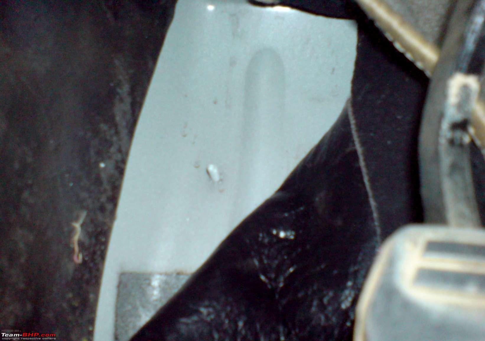

I wonder what might be the purpose / function for this bolt sticking out of the floorboard behind the clutch pedal in all VLX Refresh models (at least those that I've inspected, including mine). Just ruined a good pair of shoes on it. There is no provision for a dead pedal here (which the bolt might have held in place). Cannot figure out what purpose it serves. It doesn't seem to be holding anything on the underside of the car either, but the head of the bolt is behind another partition and cannot be removed.
Mahindra Scorpio : Issues & Solutions-abcd0001k100.jpg
Mahindra Scorpio : Issues & Solutions-abcd0020k100.jpg
Is this a redundant bolt? What do I do? Cut off the bolt flush with the floorboard? Or is there a purpose for this bolt to be there?

It would be best to just cover the bolt with a rubber pad,say 4"x4"x2"
That would keep both the bolt and your shoes happy

Could be M&M's way of testing the bolt for the dead pedal before the US launch.
