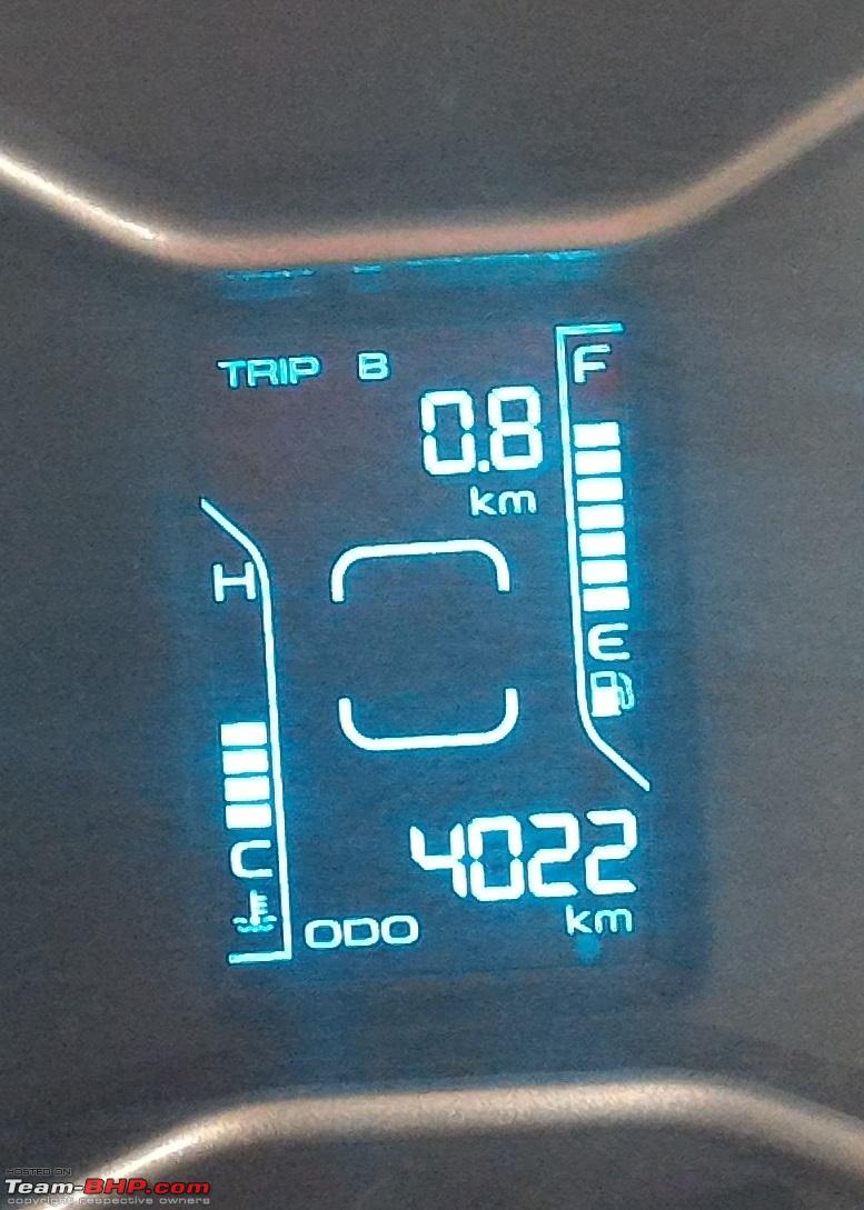

I noticed a problem today in R3. The fuel meter did not light up all the way to the top like it usually does on a full tank.

The first time it happened, I thought it could be a case of less fuel. As I had asked the attendant to stop fuelling at auto-cut, I thought may be it's a case of vapor lock.
So as soon as this was noticed I stopped, turned around, and went back to the bunk. The auto-cut tripped again. But the fuel meter reading did not budge. I asked him to manually fill in diesel till the brim, while gently swaying the car. Another 3 litres were ingested this way. The fuel meter reading stayed where it was.
Interestingly when I turn the key in the ignition , and the dashboard lights up, I can see the fuel meter light going up all the way to the top before climbing back.
I am not sure if this could be an issue with the float or something else.
Any ideas people?
An update.
I went to the Koncept Mahindra service point, and the ever smiling Manish and Rajinder acknowledged that this issue was that of a faulty sender/float.
As a rectification would involve draining the tank, I decided to get it attended to in the next service.
Mysteriously enough, thereafter, the sender decided to behave itself and now shows a full tank - albeit after having been driven 11 km.
Mahindra Scorpio : Issues & Solutions-p_20151220_121752.jpg
Problems sorting themselves out - now that's a first !!

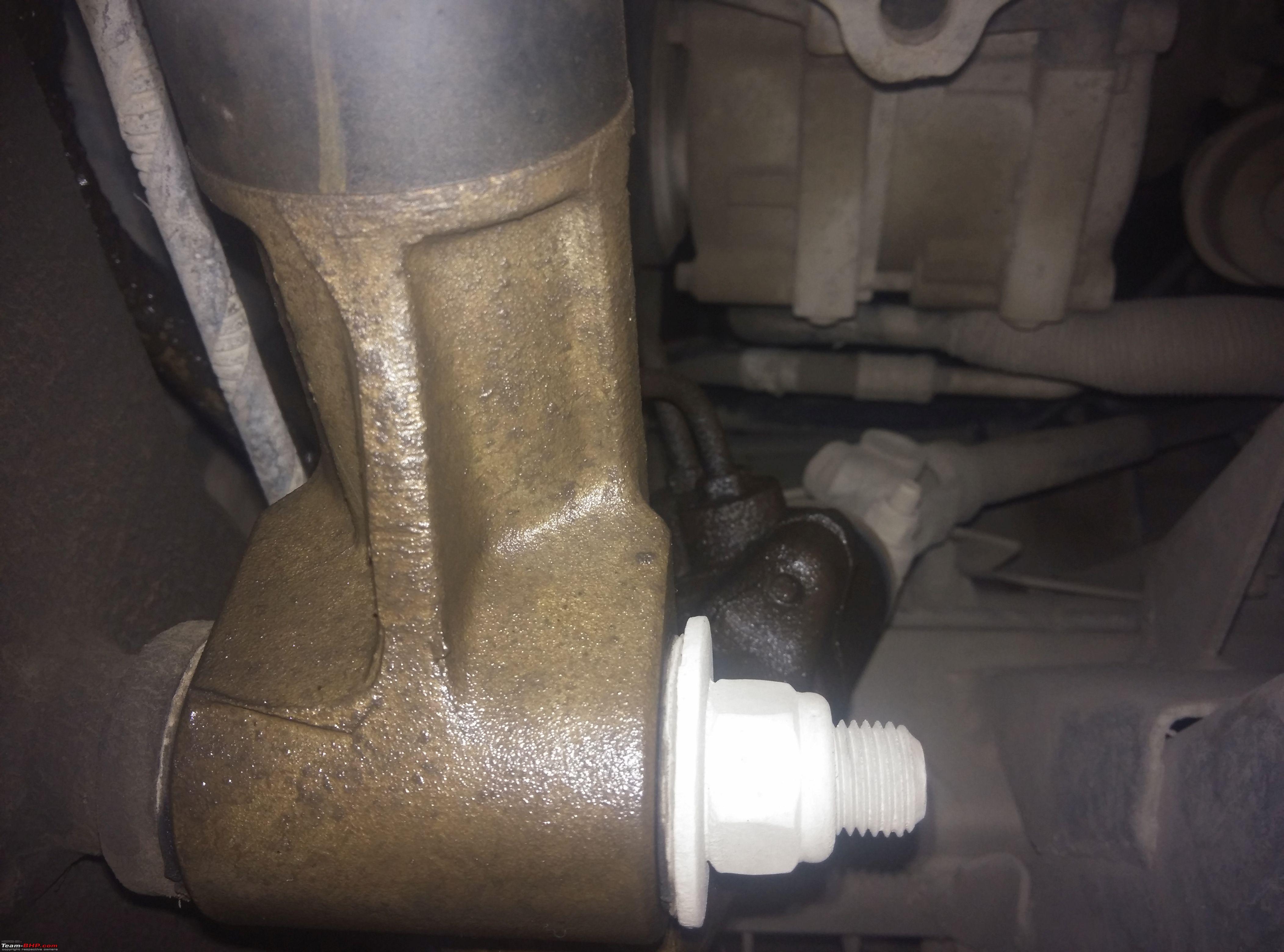

Seems that power steering is loosing oil! Any takes??

Took some picture from beneath, looks like its the power steering , correct me if i am wrong?
